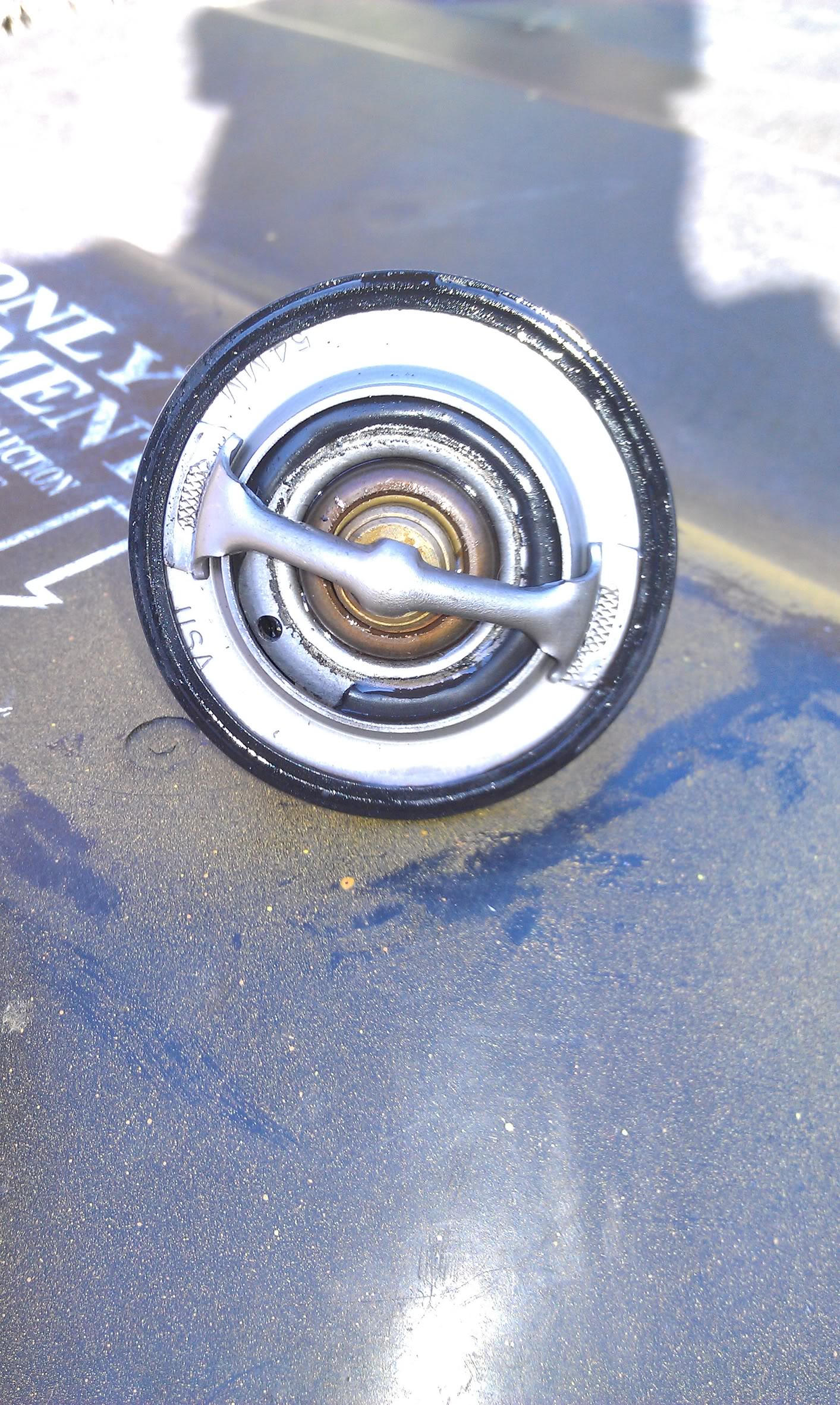

Changing my Thermostat(Tstat) on a 2006 LS.
Going to edit the thread as I work on it....

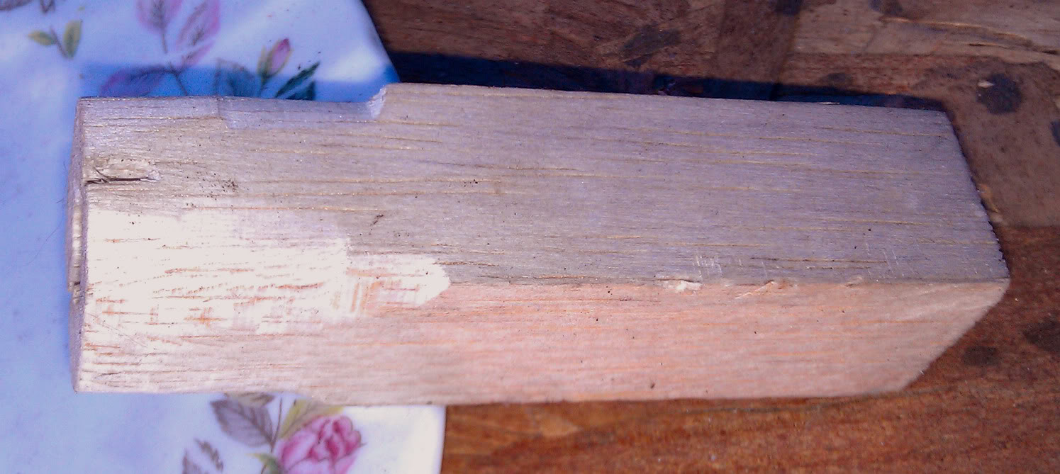

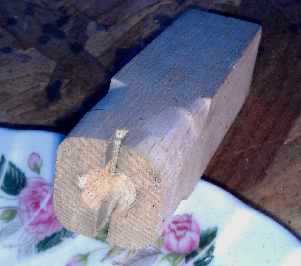

So far, jacked up and found the pet****, SOB! Are these engineers on drugs? Only way I could get to it was from the bottom, my arms are not small enough from the top. Then reaching up and around the cross member makes for very little room and strength to trun the pet****. So I fabbed a tool that fits over the pet**** and lets me turn it back behind the cross member. Picture to follow. Radiator is draining right now, didn't pull the pet**** out completely, figure it will be easier than trying to fit it back in. Why the heck didn't they use a hex head on the pet**** and let us get at it with a socket and extension? Like I said, Engineers!(LMAO, the forum thinks the word petc0ck is a bad word?)
OK I'm off to disconnect the battery, BBL
OK so now that the collant has drained I used a 12" extension with a 10MM Universal drive socket and was able to easily remove the two retaining bolts. The top housing popped loose easily and then with a slight pry of a screw driver the Tstat lifted out without any gasket damage or residue left over. Used a sponge to soak up some of the coolant in the lower housing so that I could wipe that area clean, dropped in the new Tstat, lined up the houseing and hand threaded the bolts in, tighten them down, DONE!
I did not have to remove the radiator hose.
Next I drained the Over flow tank and flushed it.
After that I filled it up with water, left the pet**** slightly open and put a slow running hose in the top fill opening, I had a flow of about 1 OZ per few seconds going then fired it up and let it warm up. Just enough to open the Tstat and flush the orange out. Maybe 5 minutes, shut it down, let the radiator drian, closed the pet**** and filled with new AF. I'm very pleased, a run on the highway showed a 185 degree temp with no more than a +/-2 deg variation.

The tool
Made from a Balsa block about 5 Inches long, I should have made it about 7" long
The damaged Tstat.
