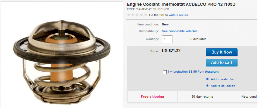

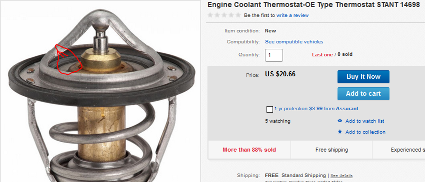

My guess is t-stat center gasket failed, the t-stat is stuck open, anyway. I believe that number is the old design.

Old Aug 9, 2016 | 03:54 PM
  #129
Posts: 26,485
Did you read any of the preceding 12 pages?
The after market t-stats and the older GM have a rubber gasket on the valve, The new GM has metal on metal seal at the valve. You can see it in the pic in #126, the center not the housing gasket.
It is that rubber gasket that fails.
The difference in the Stant numbers is the medium used in the plunger. One is wax the other is something else.
The GM part is cheaper or within a dollar on eBay the last time I needed one. When you are talking $30 does $2 really matter to you?
I just picked these at random.
