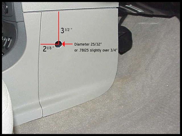

Decided to use the fuse panel / bcm cover as opposed to locating it elsewhere, moved the fuse information about 1" to accommodate the new switch. Your choice of location within the limits of the length of the new circuit.

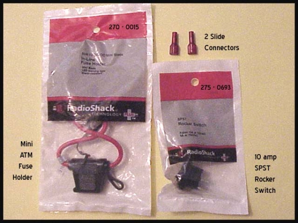

Fuse holder (Radio Shack # 270-0015)
10 amp Switch (Radio Shack # 275-0693)

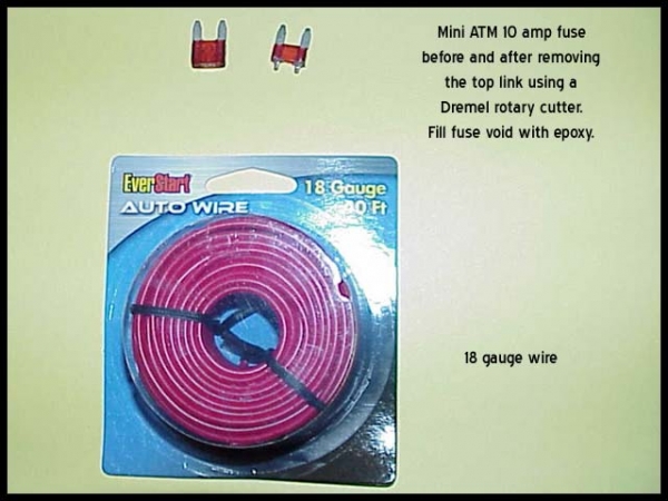

10 amp ATM mini fuse (use Dremel to remove top)

2 small insulated push on slide connectors (to fit switch connections)

1. Fill void in modified fuse with epoxy (assure that the fuse link in the center is removed)

a. Remove fuse info on rear of cover - relocate info label 1" to left from original position
b. Drill 1/8" pilot in fuse cover panel where shown in image or in your desired location
c. Drill 3/4" hole using pilot hole as a guide with a 3/4' circle cutter or Forstner bit
d. Enlarge this hole about 1/32" in diameter using a small Dremel drum sand or similar tool or file

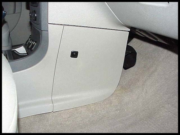

e. Mount switch in cover panel
f. Push slide connectors onto switch
g. Remove the 10 amp fuse from position # 27 and insert the modified fuse end of the circuit into fuse position #27
h. Position or push excess circuit loom/wire into open area between the bcm connectors
i. Re-install fuse cover
