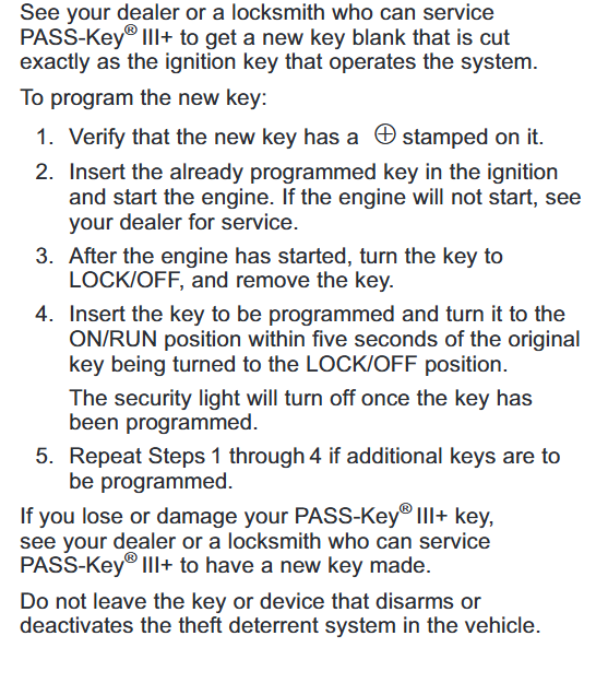

fallowed the instructions. I can start the car but if i remove the key from the ignition it wont restart.
Old Apr 12, 2017 | 09:10 PM
  #28
Posts: 26,479
From page 3-21 of the 2011 Owner Manual,
Old Apr 13, 2017 | 02:39 AM
  #29
Doolwil6's Avatar
Joined: 04-08-2017
Posts: 14
From: NC
My replacment keys do not have + on them maybe they dont have the chip
