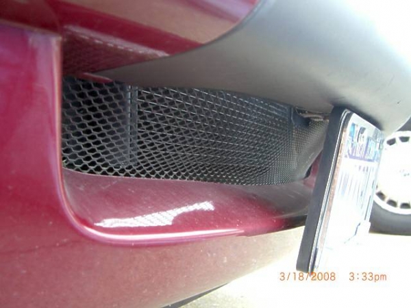

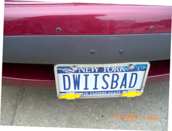

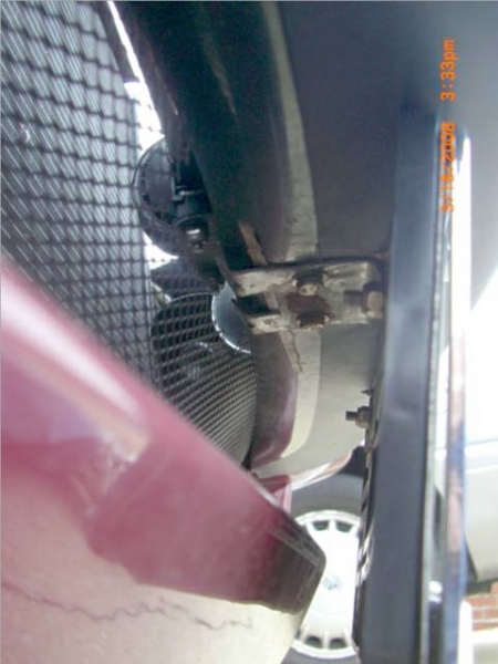

This was actually one of my first mods. I hated the way it looked on the bumper, plus it was loosened when some bozo backed into me. I believe the 2 holes I used were already there, though I may have had to drill them (it was done long ago). I used 2 additional items, both available at Pep Boys or Strauss. One was a bracket that held the plate, and the other was a large plate sized bracket that goes behind the license plate to make it more solid. Other than that, a couple pieces of angle bracket and stainless bolts with nylon thread lock nuts. I found plastic rivits that I painted red for the top and black for the bottom, then I just shoved them in the old holes. When I have other body work done on the car, I will have them closed the right way.
Notice the slight angle-this is to improve aerodynamics :-)
This is not a change that anybody would notice unless they see 2 HHR's side by side, but it really does make the car look much better, IMHO. And I have not had any cooling problems so far. The space between the plate and the lower grill opening is large enough that it does not block airflow.

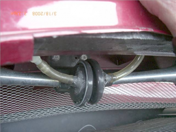

By the way, you can also see where I mounted my airhorns. This is an ideal location, since the sound is not muffled by being inside the engine compartment, yet they are out of the way from the elements.
Before anybody asks about the plate, I was hit by a drunk driver and subsequently had my right leg amputated and significant damge to my left one. That is the unfortunate reason I am stuck with an automatic tranny :-(

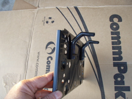

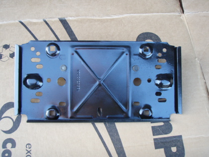

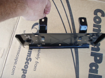

Hello All
I think I have it figured out. I went to the junk yard today and saw a license plate bracket from early to mid 80's Buick Skylark. I took it off cleaned it and repainted it. I think it is going to work out perfect. It cvame with mounting brackets and screws. It cost me $5. I am attaching pictures. I have not installed it yet. Thanks for all your feedback!
