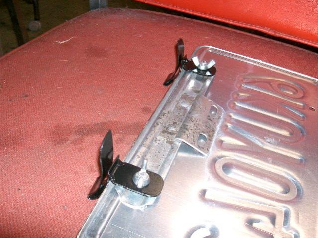

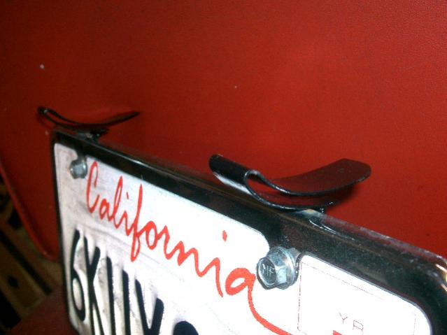

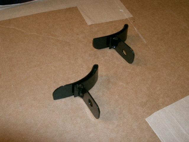

I know this is an old thread, but I though I'd show ya how I did mine...
I used an older GM base bracket and made some 'tabs' to attach to the bottom of the bumper.
The 'tabs' are actually shown on there backwards; the plate slips on from the inside of the lower bumper...
I don't even run the front plate here in Calif, I figure if I ever get stopped, I'll tell the cop to "Wait just a second" and put in on at that time. So far, I haven't got stopped for over two years...
