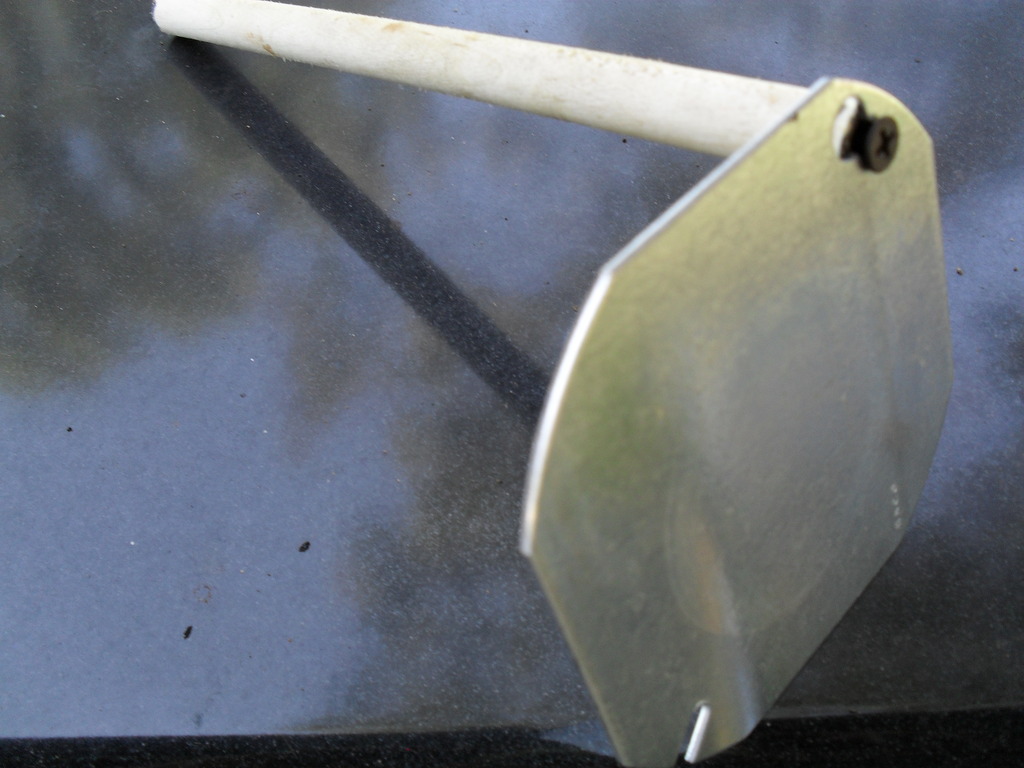

Cut the rod 8 1/2" long and attached the cover plate to it with a 1" sheet rock screw, the plate does not touch the plastic of the dash.

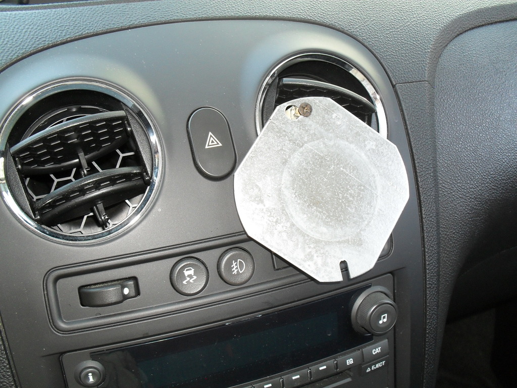

Wanted the dowel that long so it hit the back of the AC duct to help support it when I placed it in through the honey comb mess

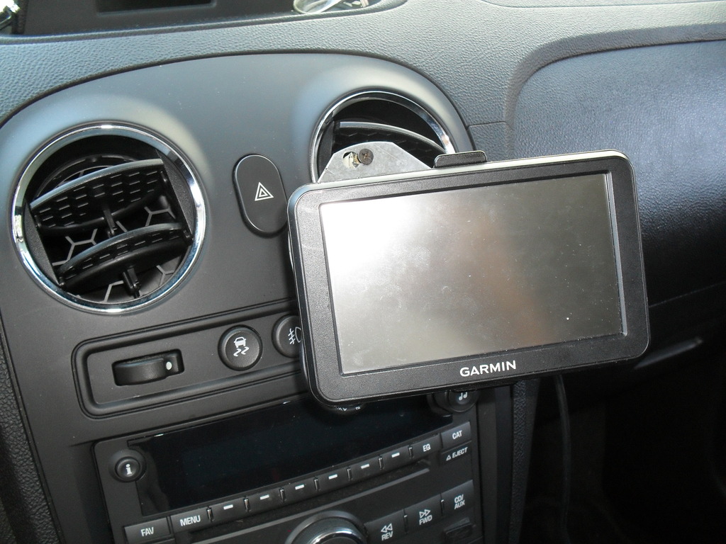

Suction cup mount holds real well to the metal plate and doesn't interfere with anything.

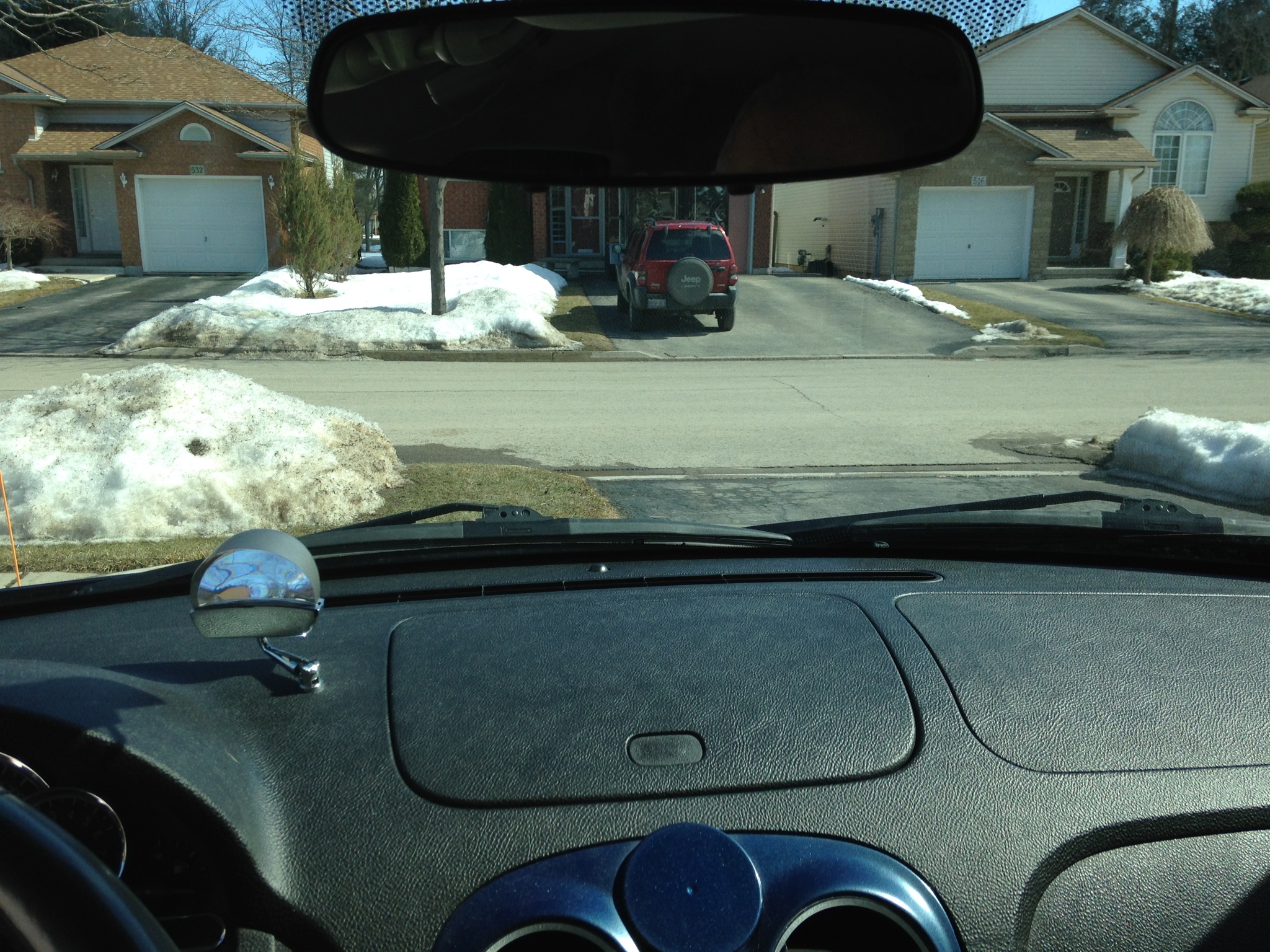

I just used 3M molding tape and mounted the GPS mounting disc to the centre of the waterfall above and between the vents

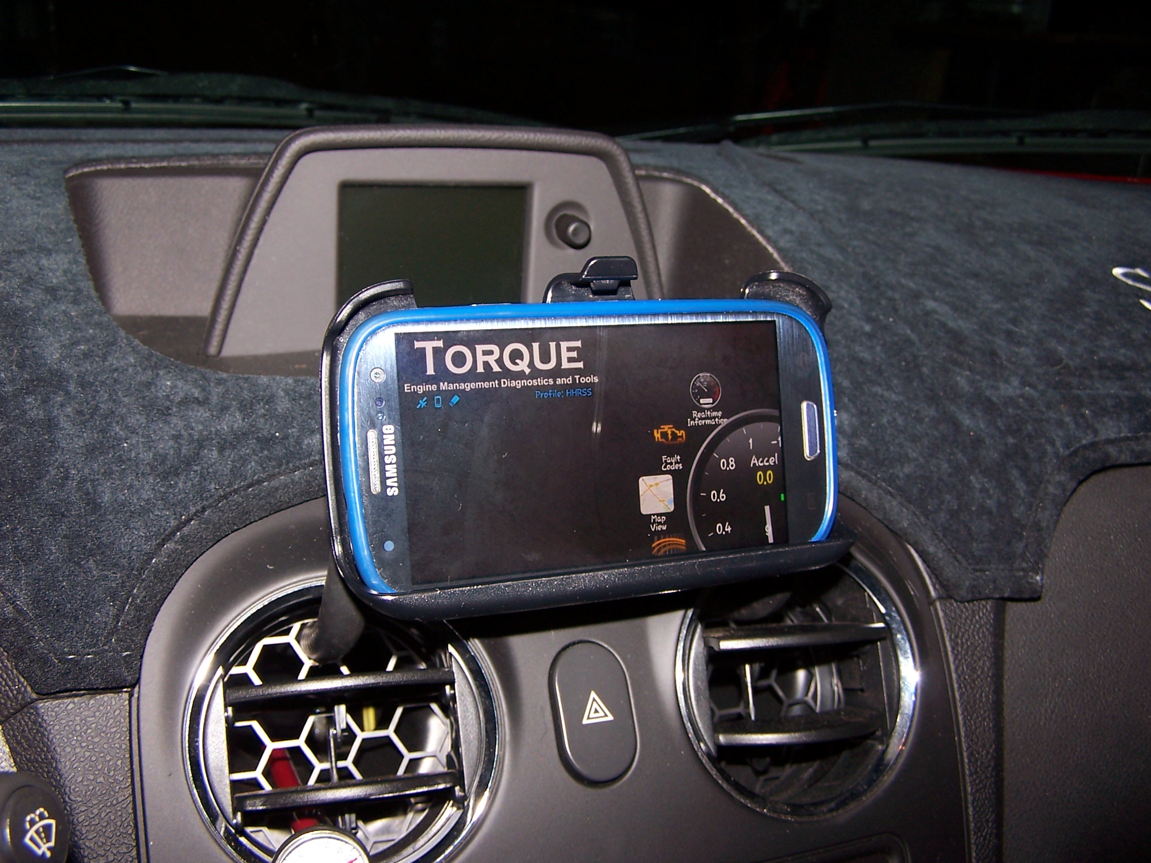

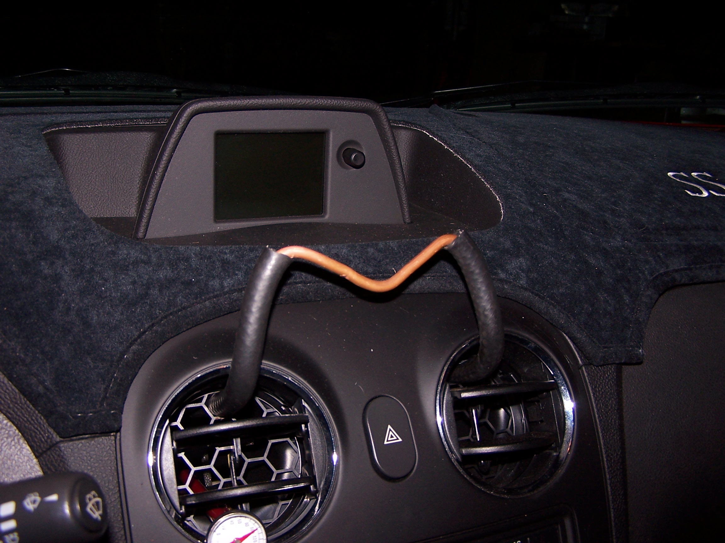

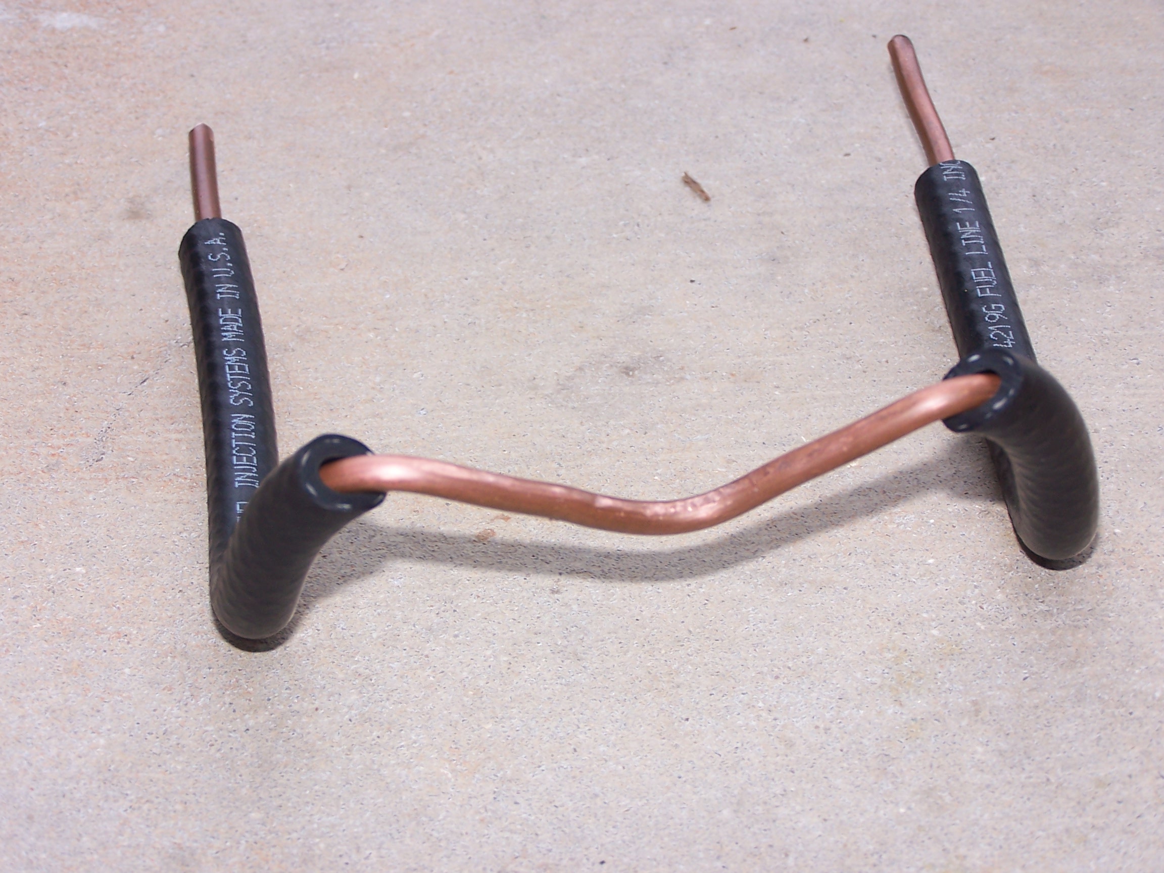

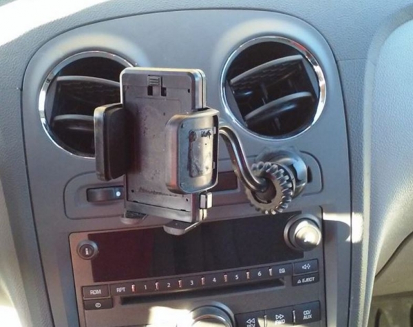

Got intrigued by this so decided to put my own ideas to work.
Using Cat Man's "vent mount" idea, I took a scrap piece of lg. diameter copper wire. Bent it to fit into the vents honeycomb. Slipped some old 1/4 inch gas line over it. Clipped on my cell phone holder.
Just a rough test piece. I might make a nicer version later on but I rarely mount anything on the dash.
Anyhow. No cost and only about 20 minutes of work.
