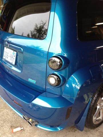

then i set up the lamps and sprayed the tint just like paint. about 10 inches away with nice strokes. you dont want any runs and it must go on evenly to look good. the directions said it should be dry enough to handle in 20 minutes, and dry to the touch in an hour. i only used 2 coats and ended up with this:
after about 45 minutes i put the lamps back in(just reverse of steps to take apart)

After the "tint" has dryed...apply about 4-5 coats of clear. Let the clear dry. Then wetsand with 2000 grit sandpaper. Then...with my angle buffer (if you have one) buff them with compound (I used 3M Perfect It). And the finished product....:
