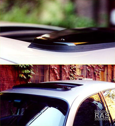

Before you go haulin a$$ down the highway feelin’ good that you’ve fixed this issue , you need to get one of these
and install it or the wind will come in and blow out your ear drums and could possibly damage the headliner if it goes inside of it.
