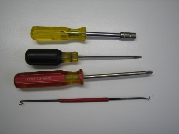

Picture of tools I used:

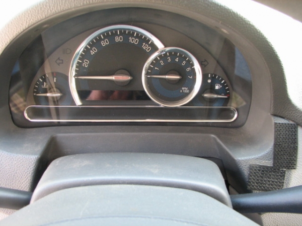

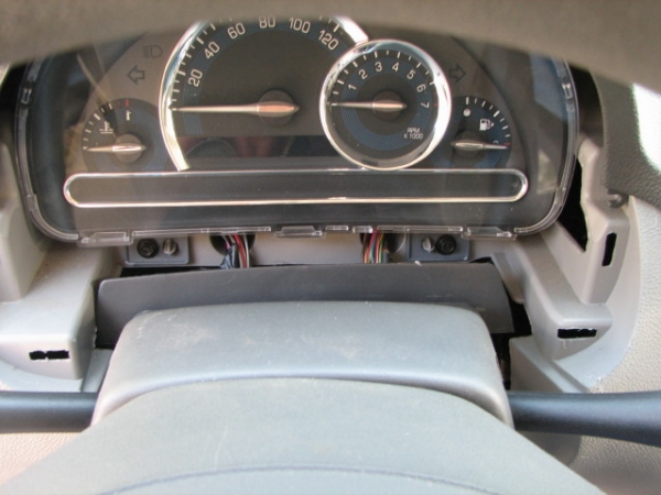

The first panel to be removed is the one surrounding the instrument panel. I used a very small (1/8” blade screwdriver) to pry the two lower sides towards the driver and then pulled the panel up and out. You’ll have to work at it some; the solution is to pull straight out. My vehicle did not have the two screws at the top holding it to the underside of the dash. Possibly because they are not necessary or the dealer left them out after having replaced the switch assembly twice before. Look to see if you have any screws installed before starting any prying; remove the screws first if they are present.

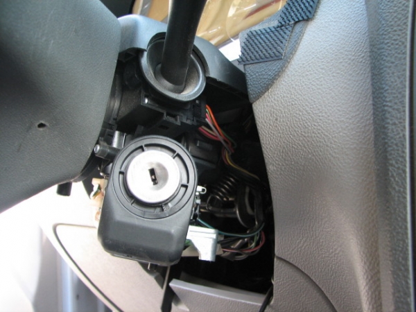

Remove the three screws from the bottom Steering Column Cover. A 7MM Nut Driver or socket is needed. Remove the bottom cover – it is snapped into the top cover and will take some fidgeting to get it to release at the joint.
Bottom removed

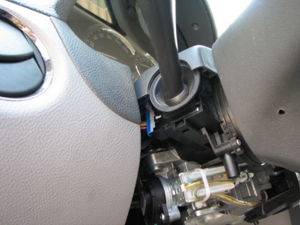

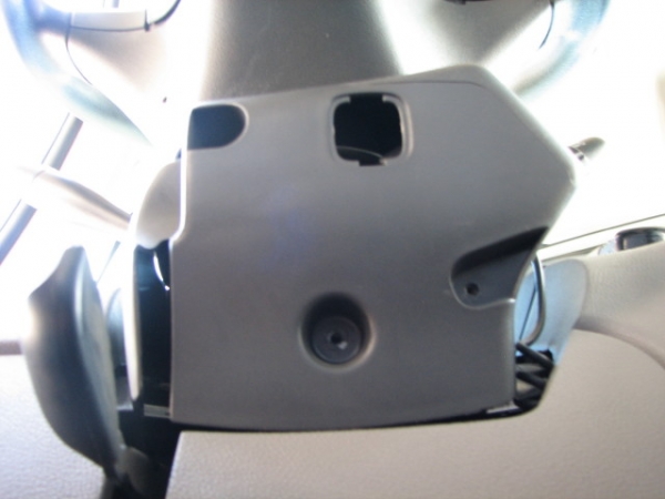

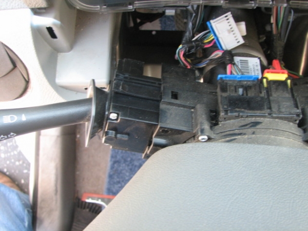

The top Steering Column Cover easily lifts off in the direction of the roof.
Top Removed

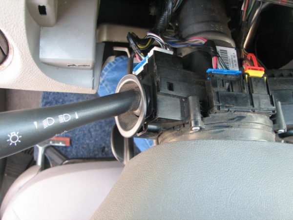

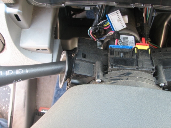

In the above image you can see the two electrical connectors plugged into the front of the assembly.
Unplug the wiring harness connectors - there are two.
Use a small flat blade screwdriver to release the top and bottom retaining clips of the switch assembly and slide the assembly out towards the driver’s door. My Steering Column had to be adjusted to its full up position to get the switch out of the steering column.

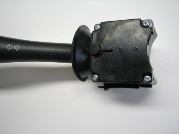

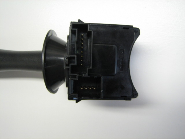

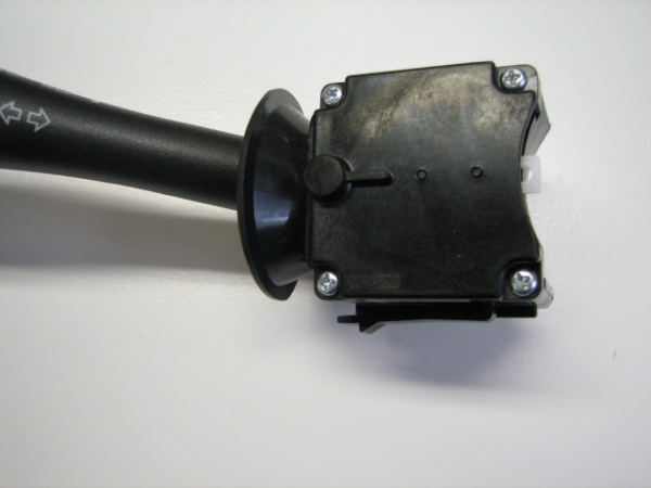

Now lets take a look at the switch assembly and what was wrong with my switch - your switch and problem may of course be different.
Operation of the turn signal canceling:
Notice the milky white actuator on the right side of the pictures.
The first picture shows the neutral or canceled position. In the second and third pictures the canceling actuator is waiting for a lobe on the steering shaft to come around and trip it to return the turn signal stock to the neutral position. In my case the actuator rarely came out of the assembly to be intercepted by the steering shaft lobe.

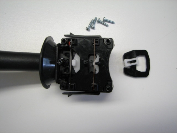

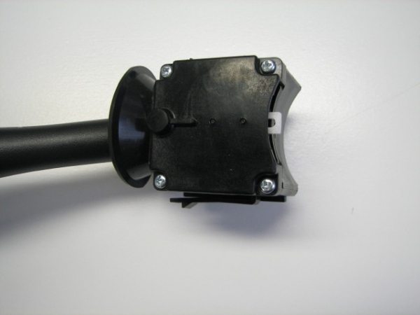

Remove the four #2 Philips screws and the cover and a few small parts – notice how those small parts are positioned so you may return them to their proper positions.
Notice the flat, gold or brass colored spring on the right – that is where my problem was. It was permanently bowed towards the driver’s door – it needs to be straight or bowed towards the steering shaft.
This picture shows the bow in the correct direction.
I used a pick to release each end of the spring from the switch housing and reversed it so it had some bend toward the steering column. Now I put everything back together.
Proper operation:
The actuator is extended, when in the right or left turn signal position, and waiting for a lobe on the steering wheel shaft to come around and trip it causing the stock to return to the center position.
In conclusion, I believe GM’s supplier simply installed this one spring in the wrong direction. I have been running this for 6 months and haven’t had a problem. If this problem occurs again I will first try reversing the spring again, bending the spring or fabricating my own spring design.
