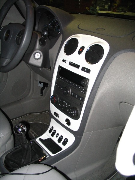

I would like to add a few things... in the hopes of making this easy mod even simplier!
So you know what your up against for those that have yet to rip and tear into your HHR. This type of clip is used all over your HHR!
..and for those that may never take the cover plate off the light pannel, here's what under there!
Mine is a manual, so your auto may look slightly different.

I sure have a few coments on this MOD about the center piece! I did it with minimal cursing! There are some do's and don't for sure. I made a couple of mistakes on the reassembly steps. Had to back track slightly. Just enough to GRRrrrrrr!
I'll add my reassembly tips tomorrow. Just so it's easier for the next guy who does this.

Looks good Sindy.

That really looks great Sindy...!! I'm a big fan of the white, and I would have bought a white HHR, but the last 3 vehicles I had were all white, so I was ready for something different...
Great job on the dash Sindy...!!!
