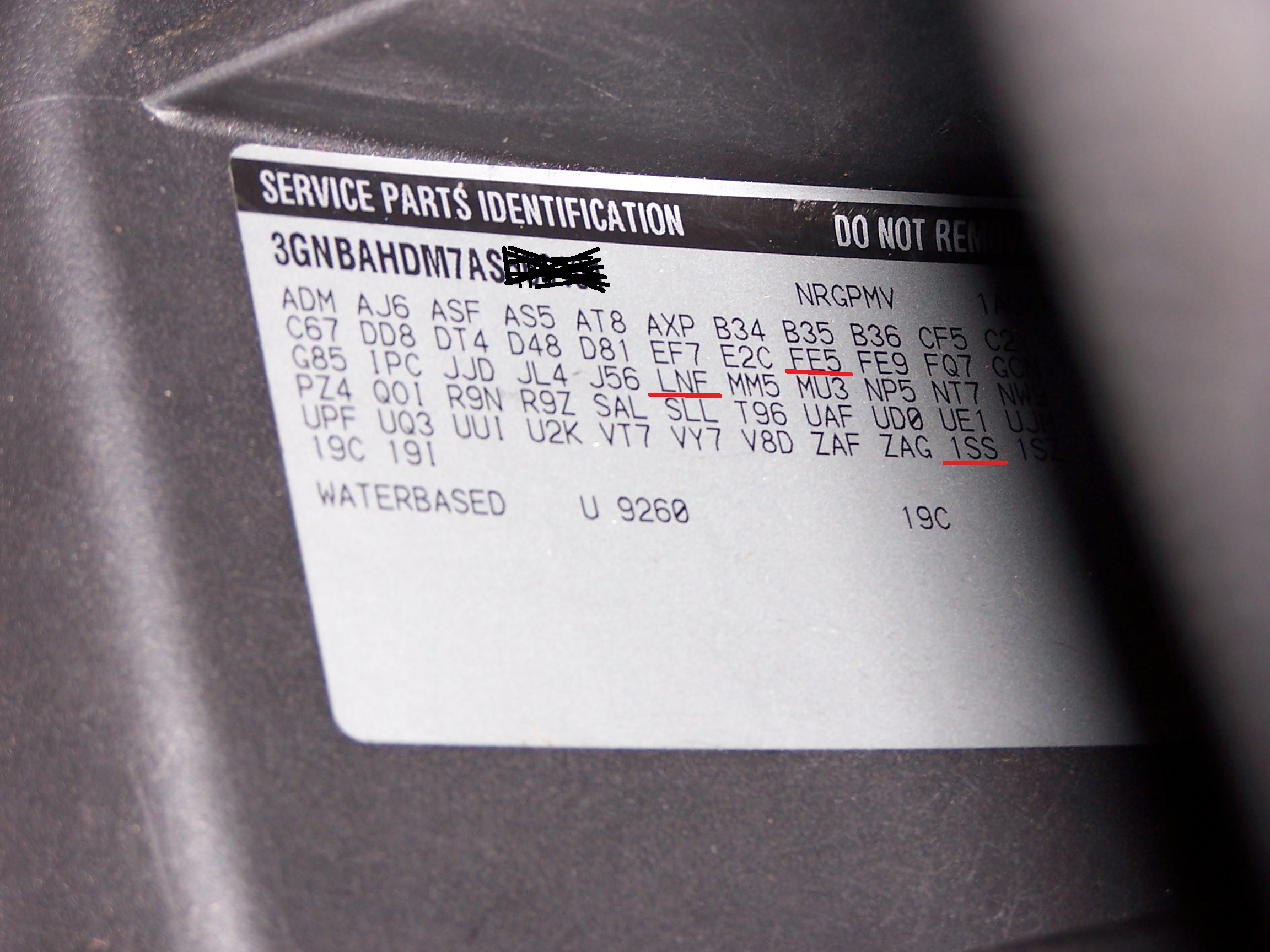

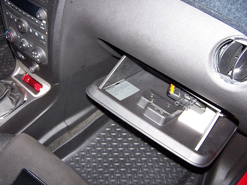

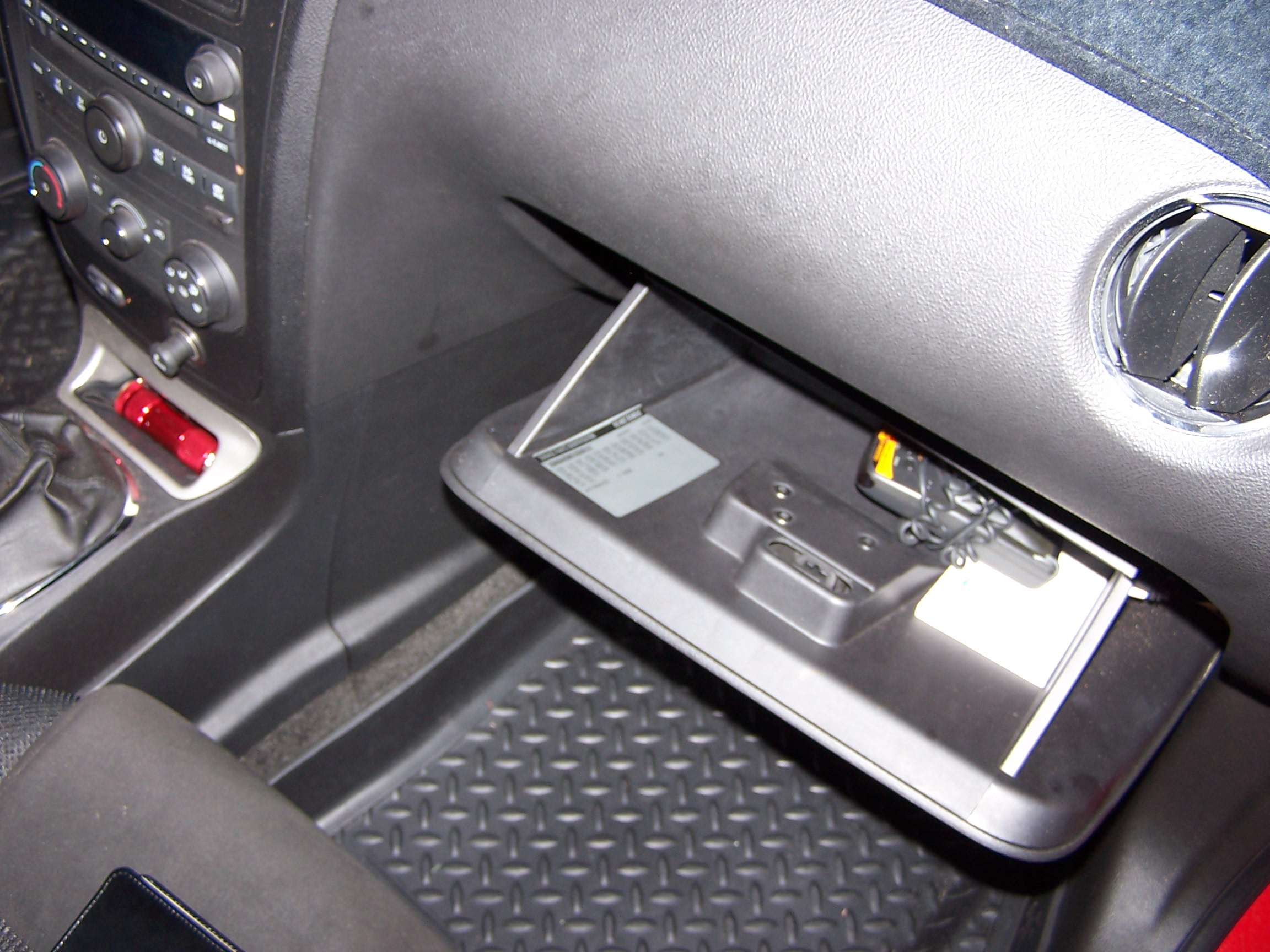

Originally Posted by IneedanHHR
I CAN'T SEE the glovebox sticker.
It's way in the back, behind where the box itself sits.
As stated before. RELAX. Take a breath.
Now. The RPO sticker in the glovebox should be on the door itself. Then just look for the codes that designate that it's a real SS.
FE5= SS suspension
LNF= 2.0l turbo charged engine
1SS= Package
