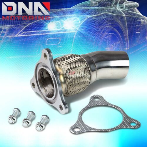

I doubt it will work. You want one with a bend in it. Ebay/Amazon etc. search "hhr flex pipe".
Your broken one is a replacement already, be sure to check the upper motor mount.
Old Jan 25, 2021 | 08:55 AM
Posts: 40,083
Originally Posted by Bobthagiant
Went with this, going to reuse factory exhaust flange
This one is to long, but you might make it fit, cut and weld, more work and you get to keep that old flange.
Old Jan 25, 2021 | 12:07 PM
Posts: 26,533
Thing is the bend will end up in the wrong place and you don't really want the flex always bent anyway. The bend is so close to the flange that those straight adapters don't work.
