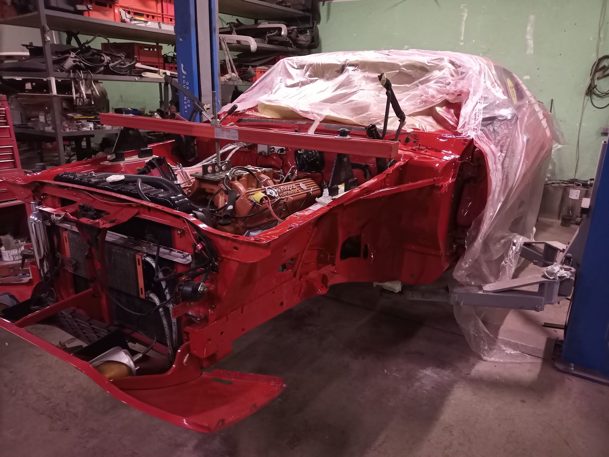

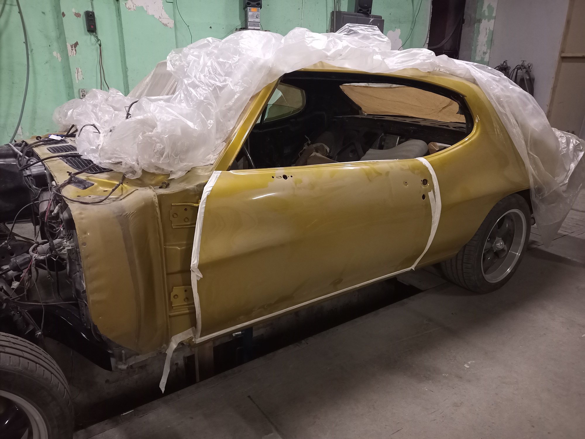

I live far in Europe,but somehow lots of US cars in the shop at the time. PS! The yellow one is mine.
