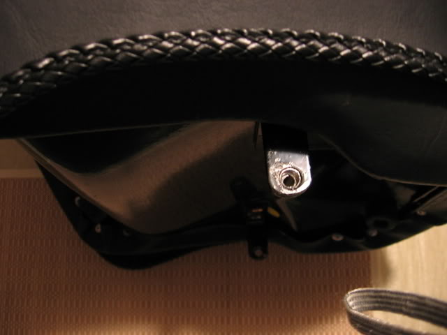

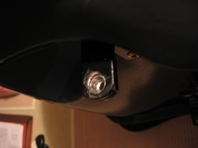

Here are some pics...it looks like there is an insert in there already??

That is a crimped in nut. It could be knocked out and replaced, or a nut welded in place of it.
I've used JB weld, fill it in, drill and tap, but not for something load bearing.
btw, I rebuild industrial equipment for a living, I do this sort of thing all day.
