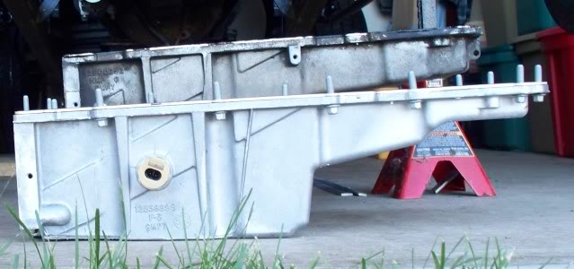

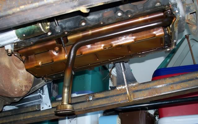

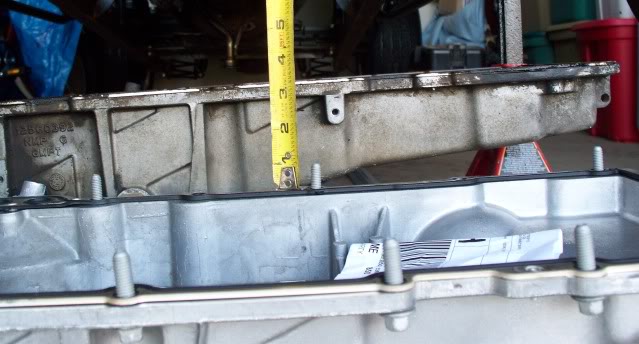

Now that the "T" is settled into it's new winter home Time to get more done. Today the 5.5 qt LS oil pan arrived and I pulled the 7.5 qt pan so you can see the difference. The shallow 5" deep pan will give me 3" more clearance and brings my pan height to 5". Here are a couple pics of the pan and the old pickup tube that gets replaced also.

Oil Pickup tube

I will be picking up some tube to make a crosser with skid plate.
Old Sep 30, 2010 | 11:36 PM
  #27
Big Difference..

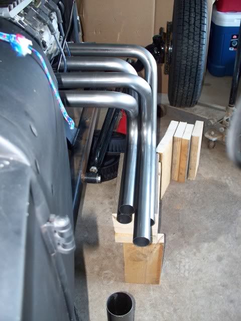

This is some exhausting work.... get it?..... Exhausting

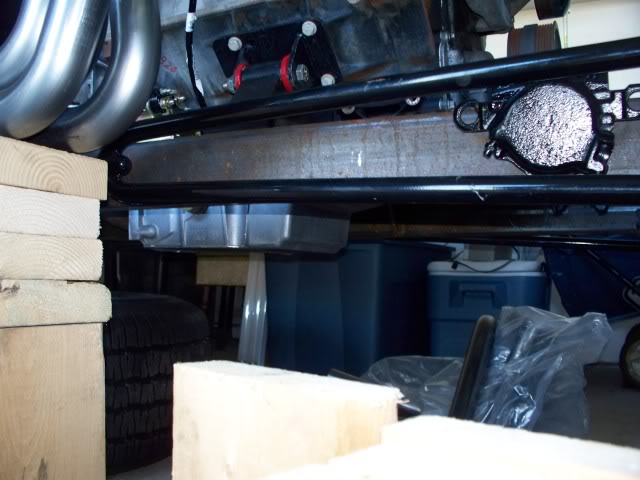

New Oil pan in place now for the crosser and skid plate

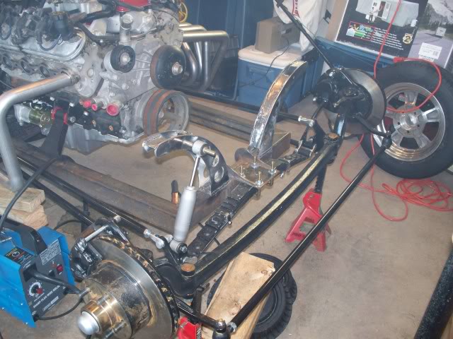

Put the front axle together with packed bearings and the brakes. I installed the front shock mounts and Headlight brackets I designed.
