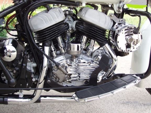

Good Stuff.. Faded memories. & Flathead freak here too.
Here's one of mine. Was 45"........ Bored & Stroked to 59" T&O flywheels.. Jim Leineweber re-ground the cams.
Chevy Stainless 6 cylinder valves shortened & re-grooved. # 6 alloy heads.
Pertronix ign. Total Seal Gapless rings. Shaved decks for optimal squish. Ported cylinders.& the list goes on & on.

But did it have Strombergs ?
Old May 26, 2020 | 09:02 PM
Nope, just some stock pos. I added a CV carb after the engine up-grade.

You didn't mention the chrome!
