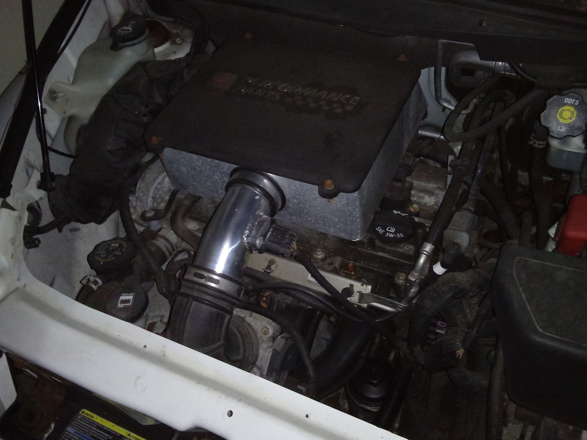

2006,2007,2008 2LT's
I've had coil on plug (4 coils) for 06,07,08 2.4s that I've owned
2008 2LT panel
