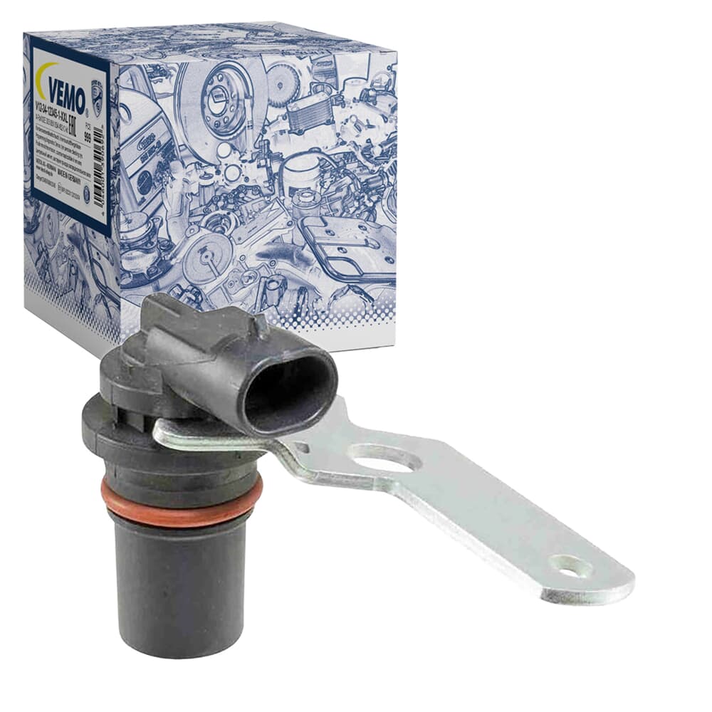

I'm writing from Germany and sure hope I'll find some help here. I need a new ABS wheel speed sensor (front left) for my 2009/2,4 L HHR. I ordered the part Rockauto suggests which was completely wrong (I attached a photo). Could anybody send me a picture or a link of the correct sensor, so I can order the right one?

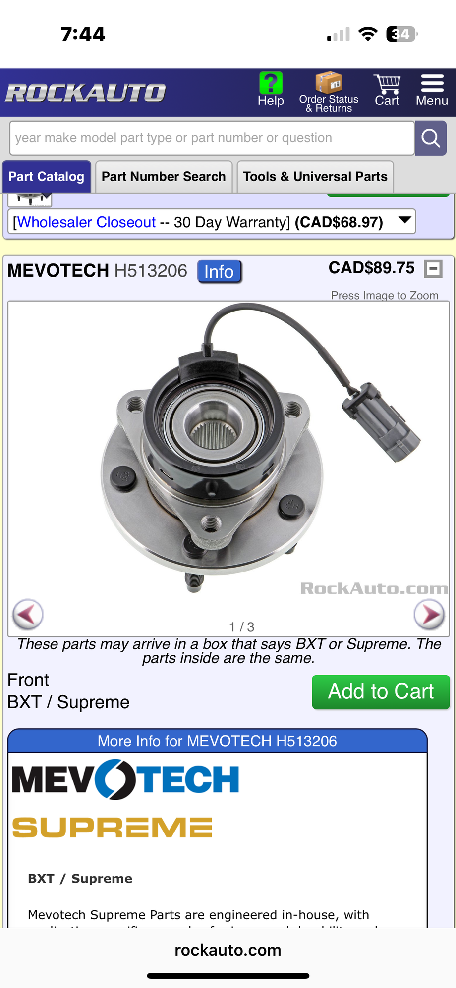

https://www.rockauto.com/en/catalog/...ing+&+hub,1636
The wheel speed sensor is in the wheel bearing hub.
Welcome to the site, what you ordered was the vehicle speed sensor the goes into the transmission lower rear passenger side .

Thank you very much. Looks like I have to get the whole wheel bearing. Don't know why I'm listed as "new member" though, since I've been here for quite some time now.

I suggest you change both front hubs, they tend to fail together.
