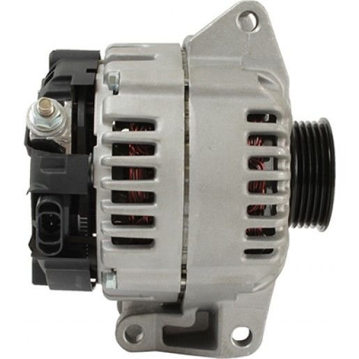

Old Dec 5, 2017 | 03:46 PM
Posts: 39,972
The 2007
https://xpart.ca/new-denso-alternato...SABEgKzNvD_BwE
The 2008 to 2011 alternator
https://xpart.ca/new-valeo-alternato...SABEgKekvD_BwE
Different part numbers, could be because of higher output, could be different connections

Old Dec 6, 2017 | 12:48 AM
Posts: 11,719
I'll guess you folks noticed that the post and plug ins are opposite/different between the 2 alternators.
Old Dec 6, 2017 | 05:12 AM
hurst2001's Avatar
Joined: 09-03-2006
Posts: 498
From: chicago
good call thanks

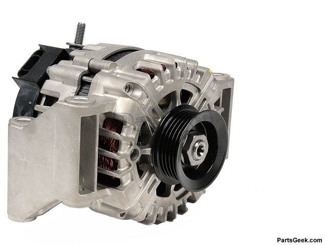

Old Dec 6, 2017 | 05:40 AM
Posts: 39,972
The same only different. I thought there was some difference, I’ll check another source and get back to you.
Old Dec 6, 2017 | 06:17 AM
Posts: 39,972
This is 2007 AC Delco , and the same picture for 2011
So they could be stock photos, some on parts websites show 120 amp some show 130 amp ratings
