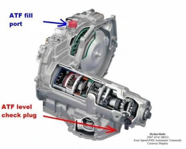

Does anyone know if you can put a dipstick on the auto trans.

Welcome to the site. I have don't think you can add a dip stick to check the trans. fluid but there is a port to check the level of the fluid.

this may help

Thanks. I know that is the way to check the oil. But I was looking for a way that you didn't have to jack it up all the way around. I was wondering if anyone had tried a universal dipstick like you can get for street rods.
Old Mar 2, 2011 | 12:43 PM
Welcome to the site woodchuckd, always glad to have more new blood. I think that adding a universal dipstick would just add a universe of problems, the biggest of which would be ascertaining the proper fluid level. I know that the lack of an easy way to check the fluid is galling, but unless you're seeing a puddle under your HHR or other obvious signs of leakage, its safe to assume the level is fine. Transmissions these days are pretty much treated as a sealed assembly until a service interval is reached, hence the lack of dipsticks. So unless you're have a leak or diminished performance, just put it out of your mind until you hit a service interval.
