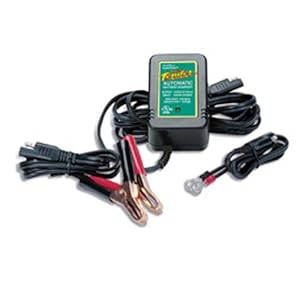

Since I ride my Bikes as much as possible, my Panel sets a lot at times.
I've been hooking up under the hood for over 1.5 yrs with one of my tenders, I use .75 mA tenders (like your pic) & never had any issues..

87-
The Battery Tender Juniors* I use are "idiot proof" as well. Can't hook up backwards or spark them. Light is red for correct hook up & charging, & goes green for float.
What I like about the one you have linked here is it can do 6V or 12V & the unit recognizes the need.. Perfect for my Flathead Harley 6V .. But only 2 year warranty.....
My Battery Tender* Jr's have 5 year..
