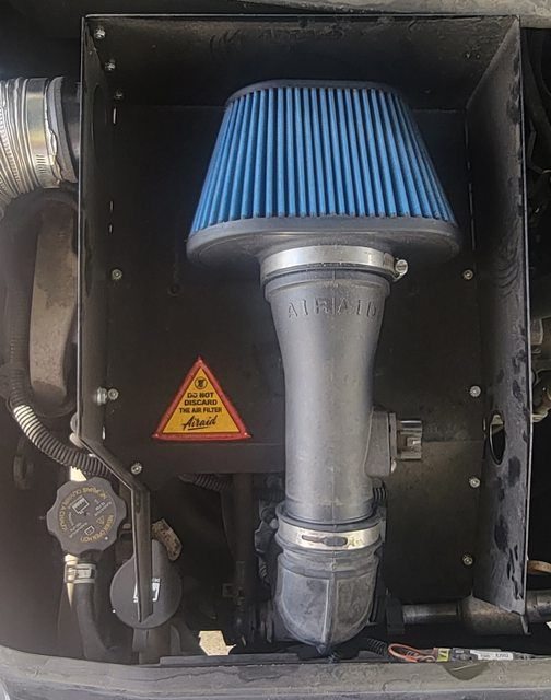

If you can find one, Airaid 203-195 or 200-195. The 200 uses their oiled synthetic filter, while the 203 uses a oil-free synthetic filter. Both are considered lifetime filters, & it makes cleaning / changing the air filter so much easier!
Here it is when it was installed in my 2010 HHR LT, though it's now sitting in my 2010 HHR LS:
Now I take off one hose clamp, pull off the filter and wash it out every 6 months, let it dry, and reinstall. I did have to bend part of the housing though, as the left side used to sit directly over top of the coolant reservoir port, as can be seen here:
