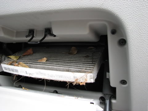

Originally Posted by JimCubb
How often should the filter be replaced?
Before it looks like this............

Old Jul 6, 2010 | 09:30 AM
ChevyM84's Avatar
Joined: 01-09-2009
Posts: 273
From: Homestead, Fl
or like this.......

... or like this:

How often to keep it from looking like that? Every 2 years?
Old Jul 7, 2010 | 01:47 PM
urbexHHR's Avatar
Joined: 02-16-2009
Posts: 6,038
From: Frankenmuth/Flint, MI
I would do it as stated, every year or 12k miles. Since I don't do the mileage, I'm at the years. I replaced it when I bought it, and I just replaced it less than a month ago now. I figure with my asthma and my allergies it can't hurt to replace it.

Thanks for making this post! Out of curiosity I checked my filter, and it looked like the one in the picture above. I'm guessing the previous owner never changed it so it had 69,000 miles on it. I purchased an STP brand filter at Auto Zone for $15.00.

yea i got the car with 16k on it so im guessing the prev owner never changed it......the one in there now has a year on it and it doesnt look good so i might replace it soon....i would change it every year especialy if u have allergies
