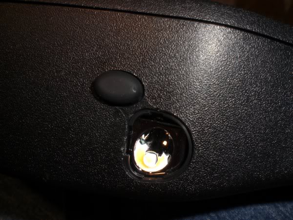

Not a very good picture, but there is a tiny surface mount in there. I think it's soldered on, not a socket. Definitely not a 194.

Did you dig out the Light Lens just for that Pic? If so it is Greatly Appreciated! I guess with the lack of replies the yellow colored led's just doesn't bother many! It bothers me! Maybe I'll check with the dealer on a price to purchase one and maybe disect it?

I've changed these lights out in all 3 of my 07, 08, 09 HHRs
All I did was go in through the lens port and with a pair of padded small Jewelers needle nose pliers pull out the old bulb and put in the new one of the same size but LED. Just take the mirror off of the mount pedestal pop open the lens and pull out the light. They do add glue to the light to hold them down so you're going to need to slowly work it out. The only problem I have come across in doing this is occasionally the light rattles from vibration and causes it to blink slightly. If it begins doing this open it up clean the terminals and replace the bulb back in the socket. And for everyone who's asking no it's not an easy standard size LED bulb. These things look like the lead mechanical pencil tips that you used to get in the '80s and would pull out the tip and put it in the rear end of the pencil. They are that small.
