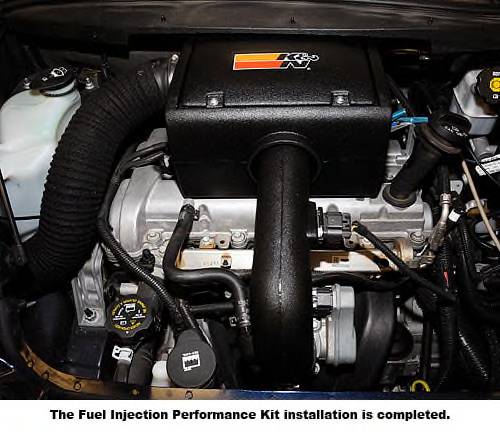

First time is the hardest.. Yes they did complicate it..
Here are 2 possible options, I'm sure there are others also..
