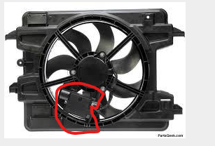

Where is the cooling fan module located exactly, I ordered the one from the link don brew recommended. Didn't see it right off. Anyone have a picture of location.

On the engine side of the cooling fan shroud

SS has a PWM controller for the fan that does wear out. It is located on the fan shroud with wires on both sides. Not very expensive, here is one on ebay; They also come with a new fan/shroud assembly.

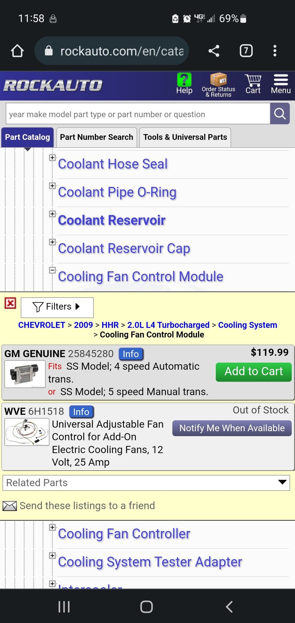

It looks different than the OE. Might not be the correct part.
Here it is on RockAuto.com

Yes this is what I was asking the location, thank you. I pray it not defective, try to get it swapped out here in a day or two. Probably easier to get to underneath the car with that location.
Oh no, you may be right, thank you. I'll see in a day or 2...
