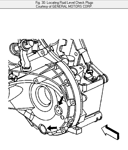

Where can I find instructions on changing transmission fluid in the 5-speed manual HHR 2.0L
Turbo?

Why would you replace it?
Simply put: drain it, refill it.
Assuming you have the GETRAG , close to the same on MU3
drain the bottom hole. fill at the top hole. Big arrow toward front of CAR.
