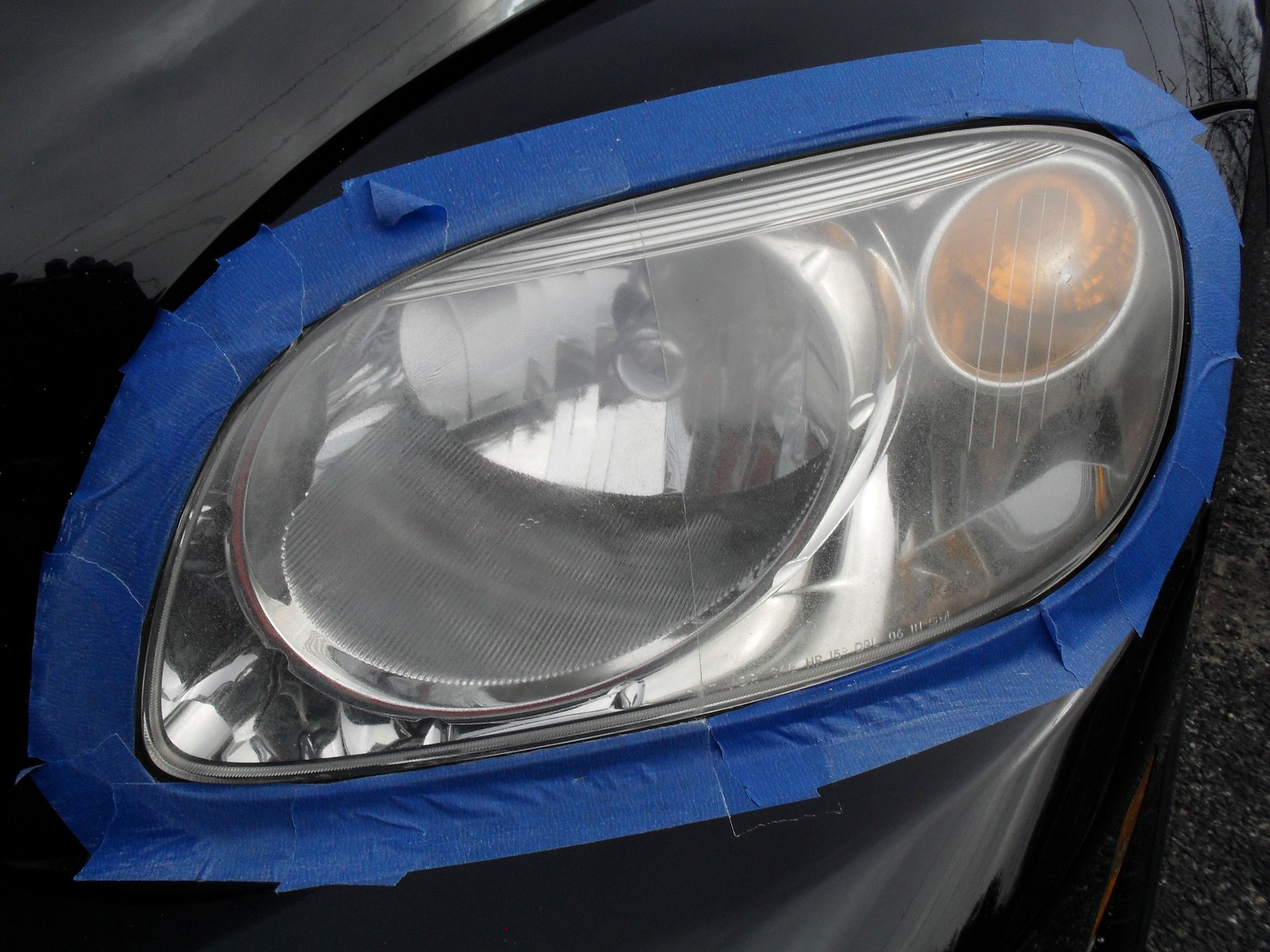

I used my Milwaukee 18v cordless drill set on #1 drill setting.
I found out don't use #2, it throws the compound all over the place.
Use foam polishing pad kit (4inch) I bought off of Ebay
Found you have to press into the drill to get better results.
A larger machine like yours probably be a better choice.
Here is a picture of half the lens polished. There is a line in the middle.
My lens wasn't that bad, but you could tell it was different from the other side
Could the polished side be better ? It's a possibility. Maybe try after the winter.
