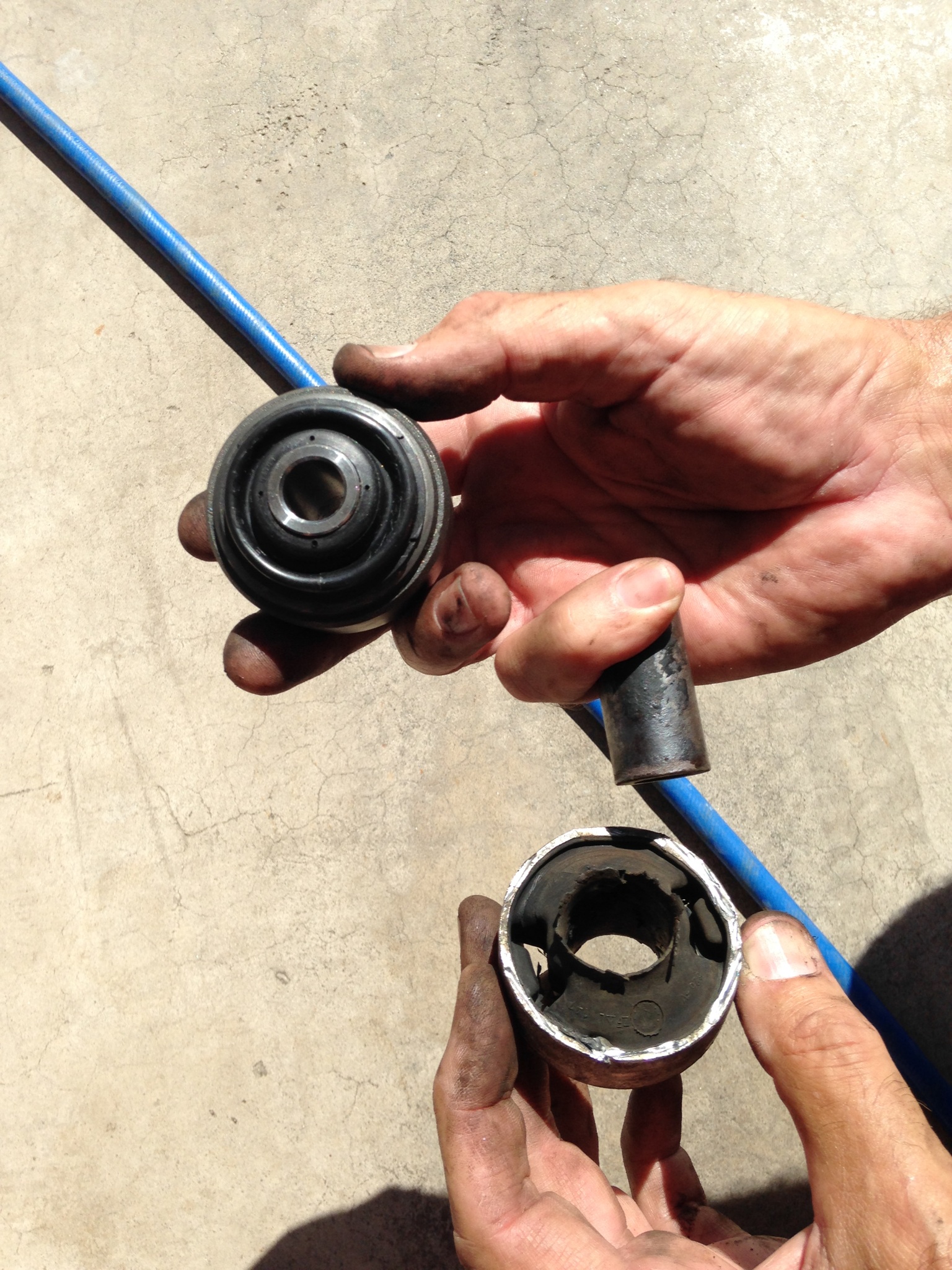

You will need a press, I used an air chisel an an old brake rotor to remove it from the LCA.
and a ball joint press to install them.
If you had an alignment prior to replacing the bushings then yes get it realigned, it will be off!
Here is a how to remove and replace the LCA
