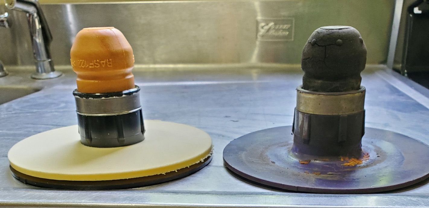

I can confirm that part 19352221 is a valid replacement for 25993737. I ordered 19352221 and put it side by side:
On the right is old part #25993737 from my 2008 LS. It is missing the foam insulator and is purple.
On the left is part #19352221
which I bought as a replacement. The dimensions are all the same, the material is the same. The only real difference is the new one is black instead of purple.
I have 19352221 installed and it works just fine in my LS. I have about 1,000 miles on them, no issues. I order from walmart, $55/each:
https://www.walmart.com/ip/GM-193522...per/1697342022

Thanks for the quick reply. I was a little gun shy about buying 1935221 for my 2008 LS, but your photos and installation comments put me at ease! I plan to have my mechanic buy for both sides (and bottom insulators too). Love to drive my HHRs (Imperial blue 2008 LS with 30K miles and red 2007 panel LS with <20K miles).
