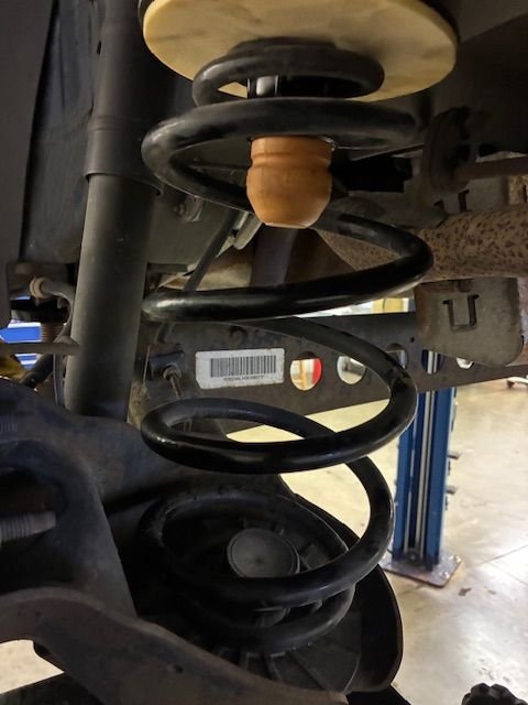

Finally!! My mechanic friend received the upper spring jounces for my 2008 HHR. I will help him install Monday, Dec.8.
Just wanted to add: many thanks for helping me get the correct parts.
The two that I received had part numbers molded into the plastic base: 25993736 = Black (like the ones I received) and 25993737 = Blue (same mold used for two different materials). And, the plastic bag had the number: GM# 19352221 The off white jounce had these numbers: BASF92>PUR< G0042-KR122-3P (couldn't find these numbers on line).
I love it when things come together like this.
If only I could lay my hands on the coil spring lower seats (many hours surfing the internet - none to be found). I hope the are good enough to reuse, though I will be measuring them for possible 'homemade' versions.
Many thanks again ....
p.s. I ordered a second set of uppers for my 2007 since they may go bad too. On order for several weeks - supposedly on the way.
Success! New upper jounce assemblies installed. And, the lower spring seats both looked in very good shape - got lucky there. The installation was surprisingly easy (with a two post lift).
