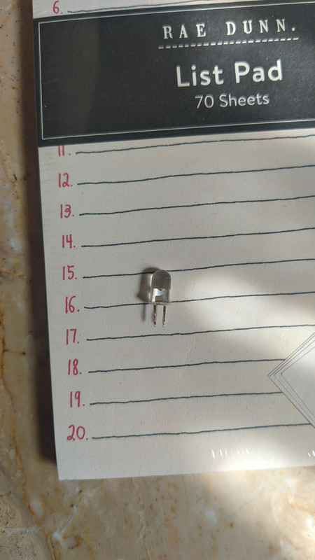

light bulb https://i.postimg.cc/FHJ53nnK/PXL-20...-192742245.jpg to figure out the proper bulb. I have tried ordering a map light and it gives me a 194 and that was wrong 😔 . this bulb is from the sunroof button area.
2010 hhr ss
Weird its not embedding.
Old Aug 17, 2023 | 03:34 PM
Posts: 40,091
It uses a standard 5mm LED. All you have to do is pull down on the little cover in the roof and it will pop off. You will see the little LED holder. Pop it out and the factory white LED is in a little socket.

Chanzon 60 pcs(6 colors x 10 pcs) 5mm LED Diode Lights Assortment Kit Pack (Diffused Round Lens DC 3V 20mA) Lighting Bulb Lamp Assorted Variety Color Electronics Components Light Emitting Diodes Parts https://a.co/d/4Bhd7LN

Thank you folks 🙏
Old Aug 17, 2023 | 04:38 PM
Posts: 26,537
If you go that route be aware that LEDs are polarized

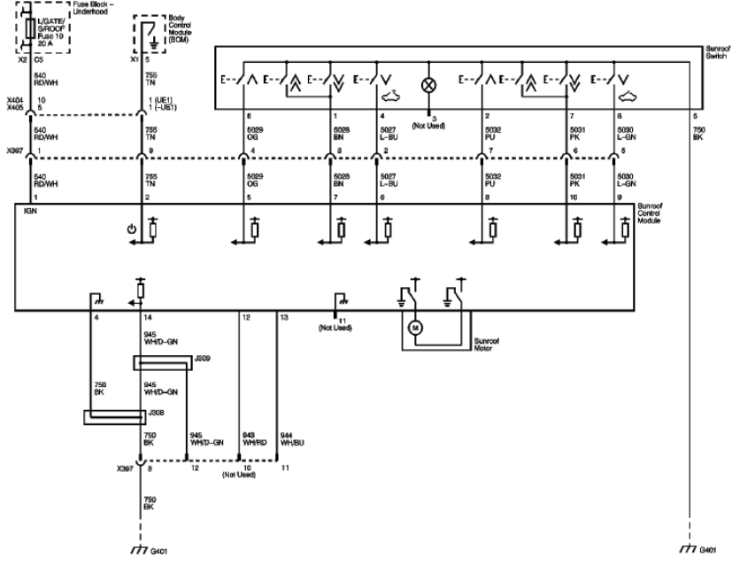

Ok i replaced the bulb and there is no power going to it. I have checked all the fuses and i cant sort out what is causing the lack of power to the socket 😮‍💨
Old Aug 19, 2023 | 03:06 PM
Posts: 26,537
Exactly what bulb are we talking about?
Probably on the retained power circuit. Do the other interior lights dim out? Is the dim knob on the dash turned tall the way left/down? Is this bulb supposed to turn on with open door?
If this is the bulb in the sunroof switch it is shown as "not used" in my schematics.

The knob that dims the interior/jnstrument panel is not dimming the lights, so i got that on order now. The bulb in question is the one on the sunroof controls, the 5mm one
Old Aug 19, 2023 | 08:50 PM
Posts: 26,537
Did it used to work? It is shown as "not used" on the schematic and the wiring diagram. The bulb is shown, but not connected to voltage. Like the same part is used in another application.
The dimmer switch also turns the interior lights on/off. That would be fuse #27 on the BCM.
