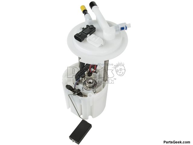

I am installing a new fuel pump. The one I bought was a
Spectra Premium SP6614M. It has the fuel connections 1 large and 3 small. Two are next to the large one. One has a in arrow and the other has an out arrow.
The old pump has 3 connection 1 large and 2 small. It does not have in arrow line.
The line lines up on the out arrow. Do I just ignore the other or plug it?
See image.

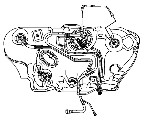

I count three this picture , maybe that new pump is incorrect for your HHR
It should look like this with three ports

I check it on 3 or 4 websites and they all say this is the one. I guess I will call Spectra Premium tommorow and see what they say. I tried to blow through it and could not so it may be plugged.

According to CARID, it's the right part. However it sure doesn't look like it. Best to call the supplier and check with them. Even Summit Racing shows it as the right part.

The one on the side of the old one is the vent, the other end of the tube goes back to the top of the tank. I guess you are supposed to get an adapter from somewhere. I am assUmeing the small one on the end is the vent, see which connectors work.
