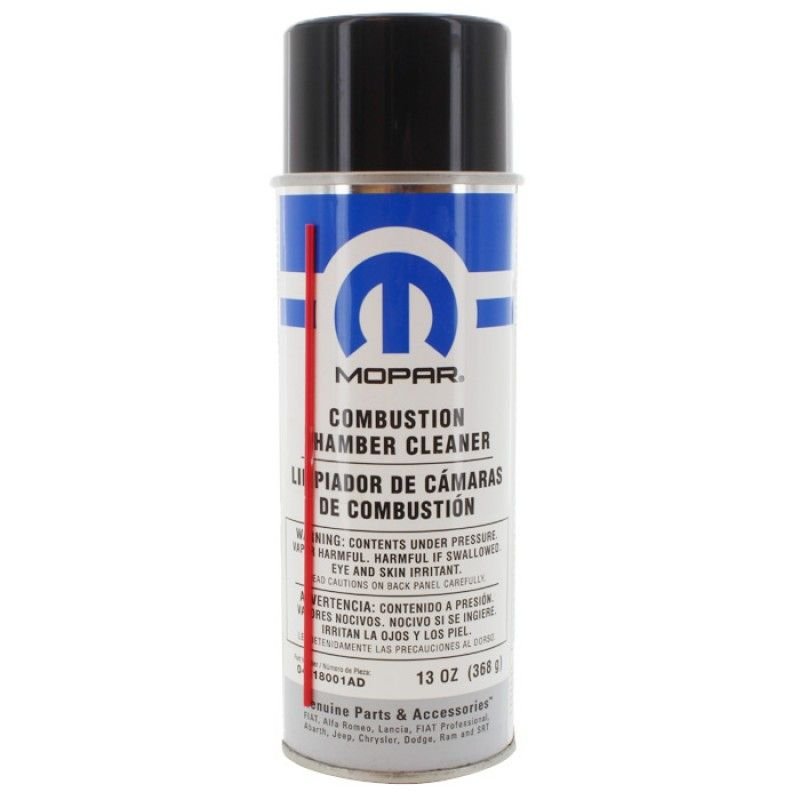

Be aware that the vast majority of carbon buildup stems from a pcv system. Can't et away from it,, it's part of the process. To this day Porsche, Benz and GM (with their high power Corvette engines) still have issues with pcv systems.
It could be worse, be glad you don't have direct injection.
Short of the pressurized specialty chemical systems dealerships have, what you used is good.
Hydrogen gas is supposed to work very well, but not a DIY solution.
This Mopar product is about the best out there for a DIY.
On older pre oxy sensor engines I always just used straight water injection whenever I got a new to me vehicle, but these days a tankful of Chevron premium once in a while will keep you clean.
It has a enough of the same ingrediant that you used.
