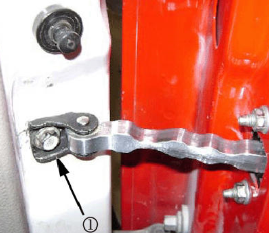

Is there some way to get the doors to open a little farther when you push the dash or fob button? One side has no problem but the other side needs to be helped along.

The "spring" is the door gasket. So, try cleaning it some of those silicone rubber treatments are sticky. There is a TSB # 09-08-64-001a about adding a washer to the check link.
