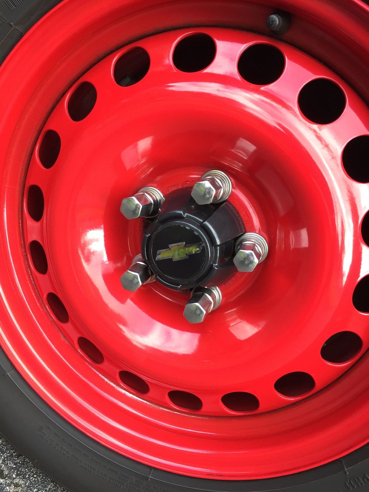

Turned out the entire problem was the hubcaps -- two of them in particular. I took them off and the sound was gone. Haven't decided what the long-term fix will be.

My rims aren't like that -- on mine you can see the brake drums.

Can't paint spokes? Or, throw the wheel covers into a corner and love the look of steely spokes.
I can't think of a way the stock wheel covers could make that much noise. Maybe 2 noisy ones are the wrong replacements; there are 2 designs of spoked wheel covers one for spoked wheels and one for 20 hole wheels.

These 5 spoke rims can be painted any colour you like! Black is very popular
