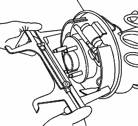

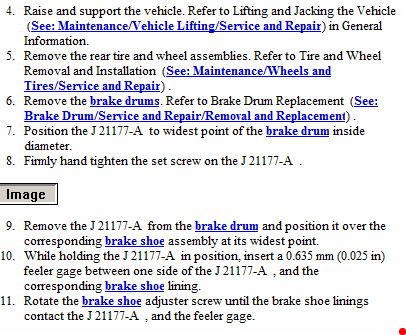

Silverfox; a GM shop adjusted your brakes that way? That is NOT the official GM Manual way. You are supposed to use the old fashioned double ended caliper with a spacer to adjust them.
From the Shop Manual:
