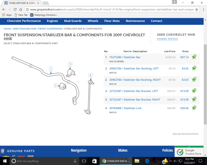

Chaosdsm, I am not trying to hijack your thread. I am dealing with the same thing.
George, to clarify:
"Sway Bar Links" and "Stabilizer Bar Links" and their associated bushings are the same part, correct? I see references to both names, but RockAuto only shows "Stabilizer."
How many bushings are there?
Old Jan 22, 2017 | 09:36 PM
Posts: 11,719
Sway bar or stabilizer bar. Same thing.
Just did a quick screen grab of this. Pay no attention to the prices since they're genuine GM stuff.
Old Jan 22, 2017 | 09:42 PM
Casa Del Gatos's Avatar
Joined: 12-17-2016
Posts: 555
From: Silverhill, AL
Boy that helps with the visualization.
So potentially two bushings (one on each side) that might have broken down on the stabilizer bar. So replacing the links and the bushings would be a good plan.
