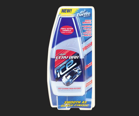

Clay bars are awesome.
Turtle Wax Ice now offers a liquid clay bar...
seems like it would work beautifully, without the possibility of dropping the clay bar on the ground. I have used the other 'Ice' products, and they are AMAZING!
http://www.turtlewax.com/main.taf?p=2,1,1,4

I will have to check this out. Looks promising but I wonder if it will be as good as a real clay bar?

If anyone tries this new "Ice liquid clay bar" PLEASE post your results..
Does sound promising...Thanks for the info..

Originally Posted by ymerej_mortsdnil
[CENTER]
[FONT="Lucida Console"][SIZE="4"][COLOR="DarkSlateGray"]Turtle Wax Ice now offers a liquid clay bar...
I have used "Liquid Clays" before and found them to be a very fine cleaning agent using an abrasive to clean your paint. Note they state there are no HARSH abrasives, but there will be some mild abrasives.
Mild is OK, but you should be careful with them.
I was not impressed at all with the ones I tried.
The problem I have with these is the fact that you are rubbing the dirt you just pulled of the surface over the area you are working on. In another words, you pull some contaminint off the surface and some of it gets pulled into the applicator/towel, but if it does not sink in completely, you are dragging that dirt all over the surface and recreating the fine scratches you are trying to get rid of. I went through 6 applicators because I was pulling enough dirt off the surface to cause swirls.
With a Clay Bar you should be constantly inspecting it for dirt, and the material is soft enough to absorb the dirt and in many cases will embed itself into the clay so it never touches the surface again. You should be turning and folding the clay bar with every new panel, if it is getting dirty. Plus a Clay Bar is floating on a surface of soapy water that gives it a very, very minor insulation from marring the paint.
This may be a fine product, and by all means give it a try. But be careful with its usage.
