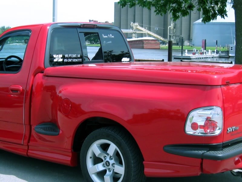

Here's my recipe for perfect paint:
The process: Wash; evaluate; correct; protect.
Tool: Griots 6" DA polisher (has the most "nuts" of any DA; lifetime warranty)
The best wash is Optimum No Rinse. A true paradigm shift; totally amazing stuff. Leaves paint glowing w/no water spots.
Claybar (if necessary)
Swirl Correction: Meguiars #105 or Ultimate Compound on a Lake Country orange or yellow pad. #105 has a learning curve, but UC is easy.
Polishing: Megs #205 or Ultimate Polish. UP will add some nice depth and wetness to the paint. Easy to use with a LC white pad. This is the step that has the biggest payoff to a wet glasslike finish.
Protection: Blackfire Wet Diamond Sealant with a LC red pad. Totally amazing slickness, wetness and depth.
You can top with a wax, but not necessary. Colonite 845 is a great, durable wax.
I top it all with Wet Glaze 2.0 on a LC red or blue pad.
