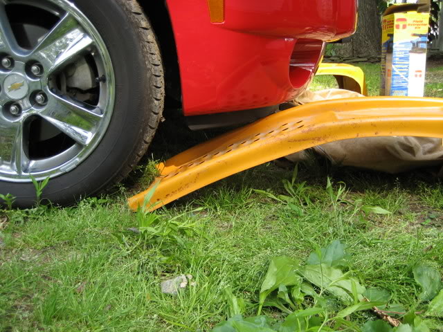

so, i figger it's time to attempt my first oil change............bought the filter, 1-1/4 inch socket...........case of 5-30..........had the ramps at hand.....
hmm, the ramps dont quite work..........

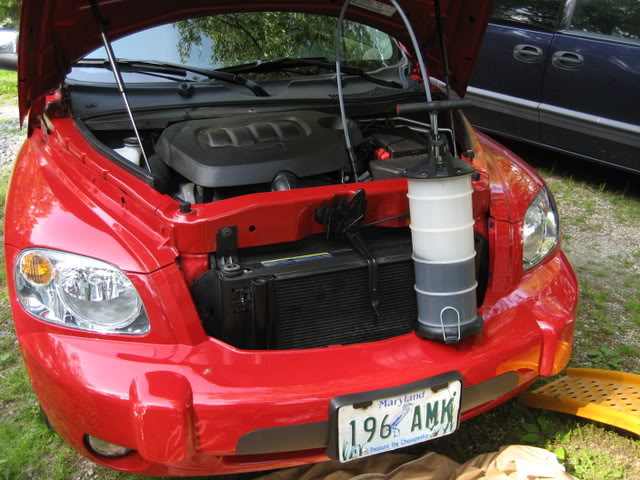

not a problem.....ugh, i can just barely reach the oil plug..........grunt
nope, i can't get enough leverage ot break it free.....
i had already replaced the filter, so there was no way i was going to drive 'er
and then it came to me...........my wife uses this suction device to drain the oil out her inboard boat motor............
man, this is the way to go............don't even have to get dirty

If you want to get a set of low profile ramps, pick up a set or Rhino ramps.
They work with the HHR.

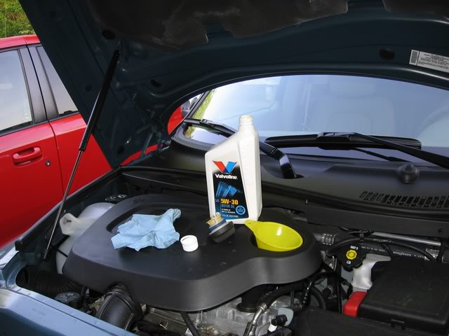

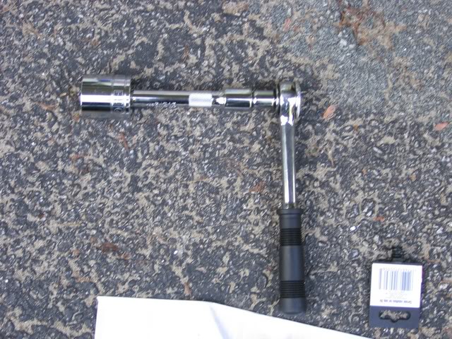

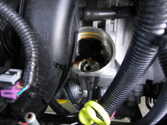

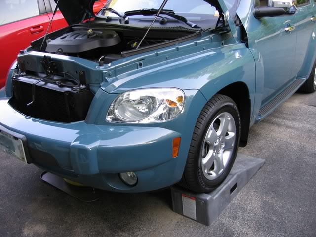

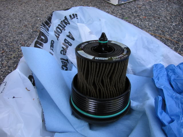

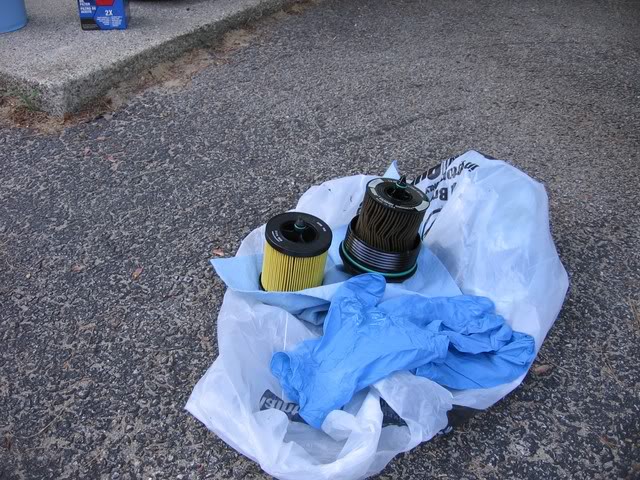

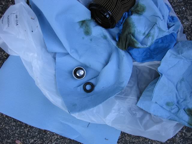

Changed the oil today....piece of cake like the guys said it was...I love the top cartridge! Very easy to change out...I took the advice here and just used the 1 1/4 socket with a 5" extension and a 3/8 to 1/2 adapter and just got the cap started ...unscrewed the rest by hand...pryed off filter from cap, soaked up left over oil in cartridge holder with clean shop towel (Blue ones), snapped new filter in cap, replaced in holder and hand tightened, the attached socket and snugged it 2 more little cranks...could have gone more but it is tight and don't want to strip anything.
Replaced gasket on drain plug, piece of cake...Mudbilly...you need to get some Rhino ramps..they are made for lower profiles cars such as the HHR...no issues, not even with flaps
Here are some pics in no order of the change

Another Kengst filter from the factory and not AC Delco.
That filter looks to be in sad shape for so few miles on it.
How bad is the oil spray from the drain plug? Projectile or a nice flow?

It came out pretty nice and straight and a nice flow...trick is to try to get plug off with your hand out of the way so when it does come flowing out it doesn't hit your wrist and splatter everywhere...been there, done that trick...I do wish that GM made their sumps so that the plug pointed down at an angle instead of horizontial...would make a simple easy oil change even easier

i dunno....
while y'all are: crawling under the car......getting hot oil on on your hand.........replace gaskets..........
i'm letting the gadget suck the oil out of my block while sucking on a cold beer......
