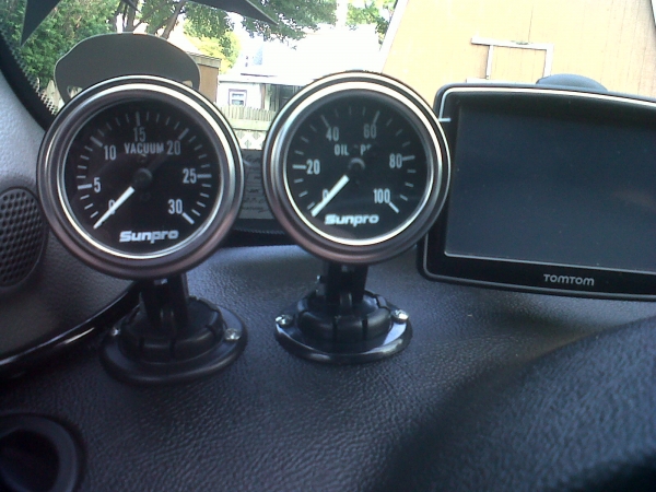

Finally got my mechanical oil pressure gauge hooked up. Used the middle galley on the back (drivers side) of the engine. Now just trying to get a base reading. Does anyone know what the oil psi should be for a 2.4? I pm'd a couple people about it too so I can pick as many brains of our great knowledgable members as possible
I really don't care for the dash mounted gauge pods. I ordered a universal dual gauge A-Pillar pod from Glo-Shift that I will modify as needed to get the fit and look I want.
