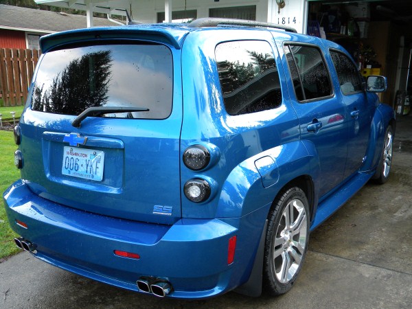

I was told it's a SS thing since I hung the tips out I only get it on the tips but the metal polish I got from Griots for the wheels and a pinch of clay bar cleans them up nice! It helps a lot with the brake dust too.

how did you manage the look of dual exhaust?
