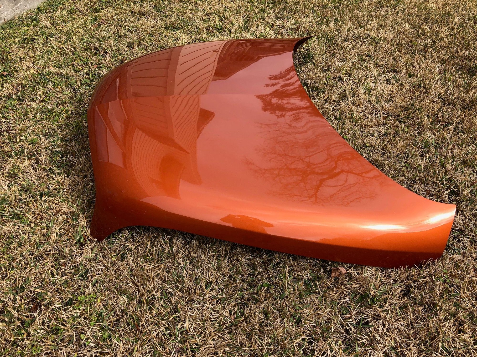

Old Jan 24, 2019 | 10:35 PM
  #26
Pretzel's Avatar
Joined: 06-05-2007
Posts: 238
From: Houston
I’m next in line for one. Got lucky last weekend with the same color hood from the junk yard for $67 mint. Car was just put out. Extractor and drip tray from eBay. The extractor by itself cost more than the hood....geez.....
