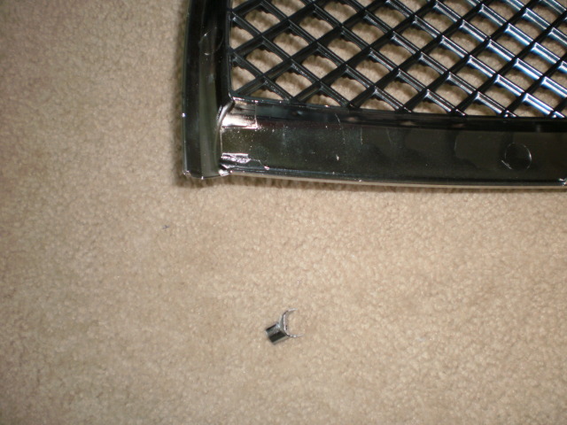

Originally Posted by Dracos
So are they screwed in, or molded in? If I damage their mount points, I should be able to drill out the holes, coat the threads with cement and put them back in....
In a nutshell, no. Happened to me recently. If you break off the mounting tab, you will have to try and and reglue it on.

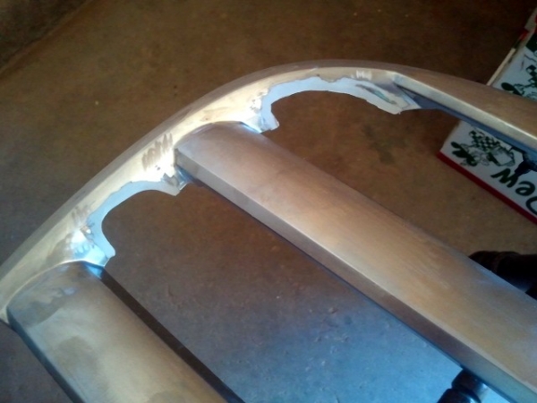

I finished the rough grinding last night, so here are five update pics.
Full view:
Bar gaps, right side:
Bowtie top:
Bowtie bottom:
Inter-bar bridges gone:
For the bar gaps, I contoured through the depth of the material so there would be less area to make new, and I'll build up thickness on the back side. Like I mentioned before, the middle portions of the removed bars (the center angle) will be recycled as bowtie edges... the top certainly, maybe a bit on the bottom.
