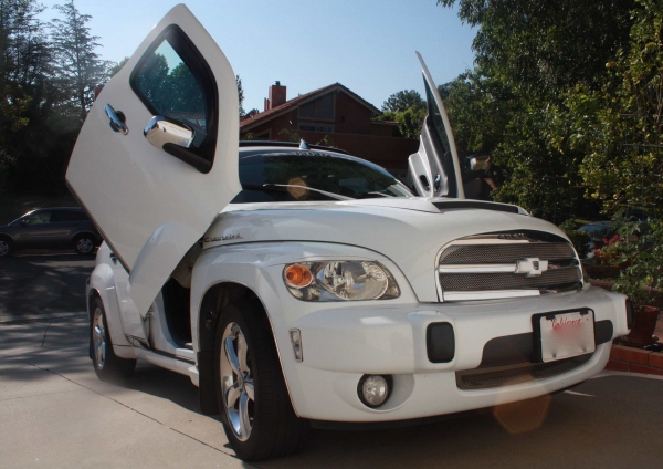

Cool Catz Driving Lights.
I have aftermarket fogs on my Lt as they did not come on all hhr's and they look and act better then the originals. Their catz fogs and they are wonderful although not being Hid's as they were not out then.
