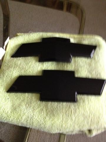

Just painted 4 of them black, planning on sticking them back on with the red 3m tape and heat.

Looking good. I broke down and I'm just going to paint them white. Going 600 grit for prep then 3 coats of white krylon fusion then a damp sanding with 1000 then 3 coats of clear.
