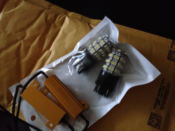

Don't forget the switch back turn signals, they are white then change to amber when the turn or hazards are on, since you will have the lights out anyway.

Might as well tell Him where to get them while they are on sale, I just ordered another set for Banshee.
http://store.ijdmtoy.com/Switchback-...3157_sku39.htm
You will need the resistor, goes between the blue and the black.
