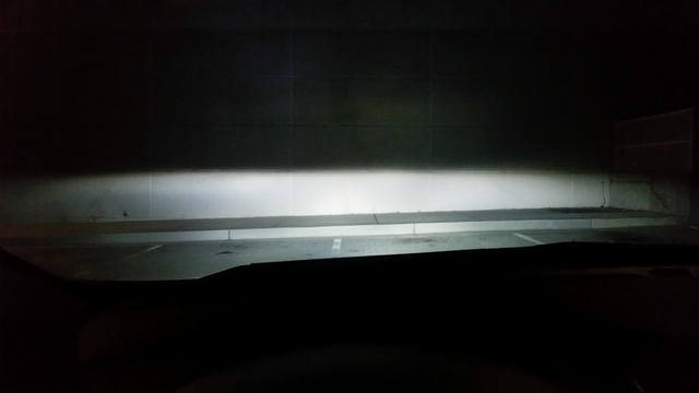

I did an LED conversion on my Elantra. Did quite a bit of research as most say there is no light output. Not sure how they work with reflectors, and especially a hi/low option. But I've very pleased with them. Personally, I'd avoid any with built in fans, as it seems the fan life is about half the LED life, but still longer than halogens. I'm using this style, rated at 5000 LM, 5500 kelvin. Plug and play.

Cut off line @ about 35 feet.

HMMMMM I am having ideasssss. I wonder about heat dissipation behind the dust cover though..... Our HHR gives little wiggle room back there and the fans on these units look bulky as well as the added/required resistor due to our wonderful CANBUS system.

Another reason I like the webbed heat sink, more flexibility. They get warm, but not hot to the touch. Bend the mesh out of the way and keep on motoring. Been running mine for over a year now.
